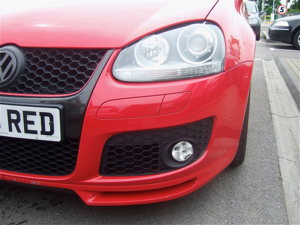

Hella have just sent me these from Germany (with a huge discount! :)). I think I'm the first in the UK to have them. Very cool - They replace my front fogs and switch on automatically with the ignition but switch off automatically whenever the side/headlights are switched on.
These LED DRL's are legal and no-one can honestly claim they are chavvy imo.
My VW dealer is fitting them on Monday and I'll post more pics etc.

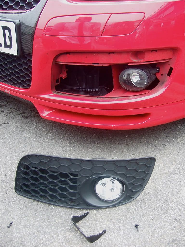

Prior to the installation next Monday at my VW dealer's, I popped by there today and they spent an hour exploring the best fit ready for Monday and to see if they needed to make any extra brackets. Dan, is now mostly in a shirt and tie in the Service Dept nowadays but as a mechanic there he has worked many times on my car, so i trust him and get on well with him and he's an enthusiast.
How many dealers would give that kind of service? :notworthy:. They also gave me a free copy of the current Volkswagen Driver magazine.
The pics show the 'dry run' :-
They fit the vents much better than the stock fogs do and also match the Xenons in shiny appearance. Strip DRL's look pretty cool but were not worth sacrificing Xenons for and would have been too difficult to make look oem. I'm looking forward to next week. Btw, the lens has DRL written on the side with Euro certification - Anyone wanting to argue I'm illegally riding with fogs on would have to get on their knees but that doesn't matter to me.

Certainly no modification of the recess/bodywork (all plastic in that area) but 'we' (Dan my VW mechanic) is investigating if he can make a simple bracket to fit the existing screw holes which the fogs use. The DRL units come with generic top hung brackets. Dan's going to use stainless steel bolts. I've left the units with him and they'll get fitted on Monday morning. The great plus is that the accident repair centre (bodyshop I use) is affiliated to my VW dealer and they look after me there too - So it's no sweat to pop next door and get something made up.
They'll do a proper strong fix and I'll be able to report on Monday. We already know that we could simply bolt straight up with a longer bolt than supplied and add washers but Dan wants to see what the best way is :notworthy:.
I'm totally happy to sacrifice my fogs but want to keep the option for someone to easily restore the fogs. I'm much more excited by these round DRL's than I expected to be.
