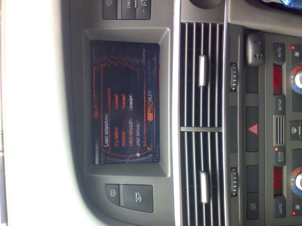

hwentzel Posted April 29, 2009 Report Share Posted April 29, 2009 Hope anyone can shed some light on my MMI problem? My MMI display screen distorts intermittently, sometimes as per attached image, other times the image rolls across the display... Audi in SA has run "diagnostics" on the vehicle on three different occasions: First, they tested it and reported that the MMI control unit reported errors so it was replaced. The problem still persisted and they ran another set of diagnostics. Then they claimed the cell-phone car-kit's arial caused interferencen with the display so they disconnected and removed the car-kit. Still the problem persisted Thirdly, the dianostics revealed the screen itself was faulty and had to be replaced. Now, as the vehicle is under mainetance plan, the insurer is questioningthe costs of replacement and I can see where this going... The vehicle is now scheduled for a fourth "diagnostics" opinion with the problem still not being resolved... Can this be a firmware issue or is it hardware? Anyone experienced this problem? And no, there is NO cell-phone or GPS close to either the MMI control unit or the display while the interference/distortion is experienced... Link to comment Share on other sites More sharing options...
