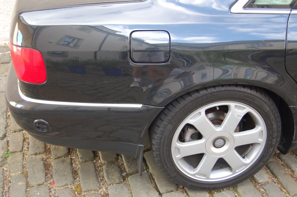

alantong Posted May 7, 2008 Report Share Posted May 7, 2008 I have a 4.2L D3 with LPG and have been running it now for about 10K miles. Its a sequential system and I am get about 20mpg on LPG. Tank is in the boot not sure how big it is bit seems to take about 80L when filled. £2.5K seems a lot to pay. I bought my car with LPG and suspect it only cost £200 more because of it. May be worth looking at selling your car and buying one already converted? BTW the filler for the gas can fit next to the petrol filler so everything is hidden under the fuel filler cap. Alan Link to comment Share on other sites More sharing options...

EddyH Posted May 8, 2008 Report Share Posted May 8, 2008 BTW the filler for the gas can fit next to the petrol filler so everything is hidden under the fuel filler cap. If I could do that on my D2 I'd almost certainly get LPG as the visible filler is a big put off. Any chance of a photo? Also can anyone recommend somewhere to do the conversion? I'm in West Yorks and have submitted an enquiry to Yorkshire LPG conversions. Link to comment Share on other sites More sharing options...

EddyH Posted May 9, 2008 Report Share Posted May 9, 2008 They're one of the places I've emailed so I'll see what they come back with. I've checked under the filler flap and the LPG filler isn't gonna fit under there. Where are other D2 owners LPG fillers? The more discrete the better really. Link to comment Share on other sites More sharing options...
Figure11 Posted May 9, 2008 Report Share Posted May 9, 2008 They're one of the places I've emailed so I'll see what they come back with.I've checked under the filler flap and the LPG filler isn't gonna fit under there. Where are other D2 owners LPG fillers? The more discrete the better really. Here's my LPG thread for some ideas. http://www.tyresmoke.net/forum/showthread.php?t=95210&highlight=plummet Mike Link to comment Share on other sites More sharing options...
Duffy3074 Posted May 9, 2008 Report Share Posted May 9, 2008 I paid £2.8 for a sequential OMVL system with a tank in the spare wheel well (Which took a lot of work but doesn't cripple the boot) I put the filler down on the bumper on the offside rear quarter. It's pretty discrete and this is my second S8 on LPG, it's well worth while. Link to comment Share on other sites More sharing options...

ghemmings Posted May 10, 2008 Report Share Posted May 10, 2008 Its autogas 2000 thats going to do mine. Its booked in for the 4th June and is about £1900 & vat for a sequential system . They've being doing them for 30years so you'd hope they know what they are doing by now and they are only 40 mins away. Off topic I need to apologize for the bad grammar in the thread title (it annoys me everytime I log on). I feel better now Excellent choice of installer. I'm sure you won't be dissapointed. Good price too! In regards to the filler location, mine is in the same place as Figure11's car, but there is a slight corrosion visible in the paint around the filler (it has been there 7 years though). I would put it on the bumper if I was going to do it again. I also don't like the idea of spioling that beautifully expensive aluminium panel. At least a bumper can be replaced relatively cheaply, and there's no corrosion. Also, demand you have the filler coulour coded with your car. You will seriously regret it if you don't. Those fillers look hideously ugly in an unpainted state. My A8 has the filler coloured, but my Jeep Grand Cherokee doesn't and it sticks out like a sore thumb! Link to comment Share on other sites More sharing options...
EddyH Posted May 10, 2008 Report Share Posted May 10, 2008 My petrol filler flap needs painting anyway so I'll pick up an LPG filler from whichever installer I use and get it painted at the same time. Just got 2 quotes so far, the one I posted earlier and another one of £1800 for a Romano system with 1yr warranty but they provide a courtesy car. Link to comment Share on other sites More sharing options...
