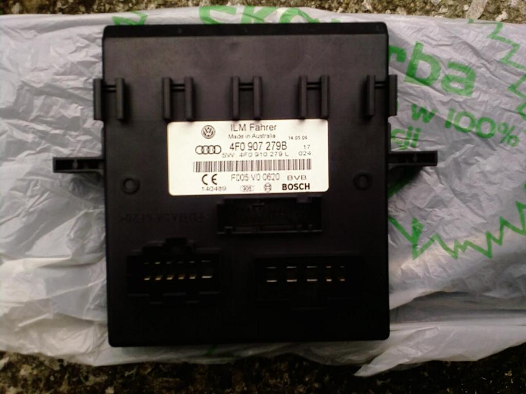

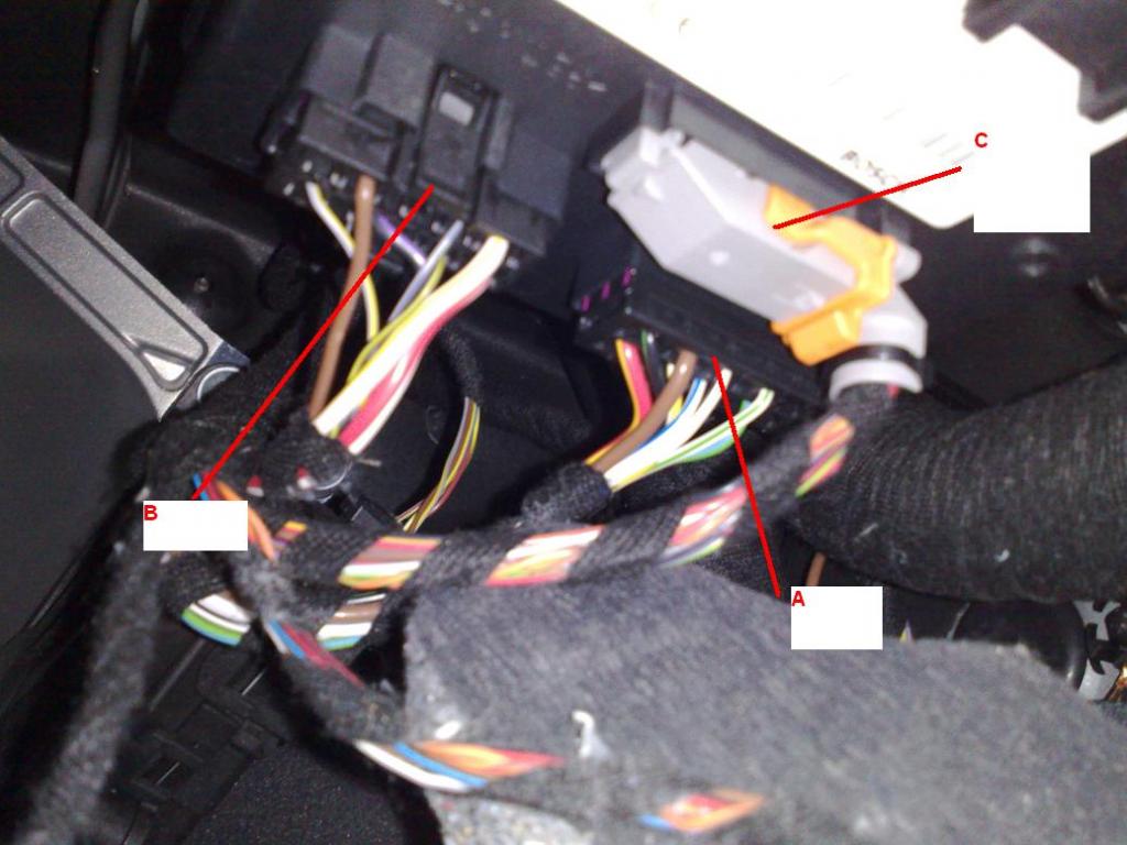

mross Posted July 4, 2009 Report Share Posted July 4, 2009 Hi guys, here are electrical schemes of "our problem":) (I've passed...) Kufatec set allows us to connect bixenon headlights without unnecesary work with connectors mounting. From each lamp there are two extra wires. First- from long beam solenoid Second-from day driving lamp. You take them into cabin, remove cover under steering wheel and if you'll lay on the floor - you will see black flat box with three connectors. This box is called "bordnetz". You put that wires to connector A and C (see pdf file!). And if you have bordnetz which is "able of xenon presence in the car" - you take vag com and recode 09 module. You must know that NOT ALL bordnetzs are able to do this. Espiecially if you got 4F0 907 279B - you will not be able to force bordnetz to accept xenons (no long beam and no day driving lights). 4F0 907 279 without "B" should be OK. So, after that you will have bixenons with long beam, with day driving lights and with no errors on fis. Of course there will be no auto levelling and no washer system (required by law - the same in Poland). On pdf - there's electrical scheme of auto levelling system. Its not easy, but also not so difficoult to do. Will not tell you what's my job, but believe me - if I did it by myself - EVERYONE will do this... For the end: Just've bought bixenons with AFS and new J431 module for AFS - on wednesday I'll should have 3 free hours. And if the weather will be fine - I will have A6 with AFS lights... There's no magic with this. Just think and u will manage it. Regards _Mross bixenon.pdf Link to comment Share on other sites More sharing options...

mross Posted July 7, 2009 Report Share Posted July 7, 2009 ... what's to stop the shutter solenoid being controlled from the existing +12v feed for the high-beam lights ? - Errors displayed on FIS and beep sounds ... - No possibility for bordnetz recoding (for xenon) ... however, in fact you will have high beam lights then... Link to comment Share on other sites More sharing options...

mross Posted July 8, 2009 Report Share Posted July 8, 2009 Without self-leveling mounted but with bordnetz corect coded you will get no errors (no errors of damaged lamps). If you decide to register J431 module (self-leveling) you will have to do all proper wiring. If you don't - you will have errors from self-leveling (or AFS) then. Link to comment Share on other sites More sharing options...
rsmck Posted July 8, 2009 Report Share Posted July 8, 2009 Thanks I've had a look and I can get the self-levelling parts quite cheaply, they don't look easy to install though - also I can't find the wiring loom as a single part (other than through Kufatec) .. don't suppose you know the Audi Part Number for this? or is it normally part of the headlamp loom which would require me to replace all the existing cables ? Will find out tonight if my bordnetz is the right version :/ Link to comment Share on other sites More sharing options...

rsmck Posted July 15, 2009 Report Share Posted July 15, 2009 Well at least one thing in this is going according to plan; Part No SW: 4F0 910 279 K HW: 4F0 907 279 Still not got the lights or Kufatec loom tho Link to comment Share on other sites More sharing options...
rsmck Posted August 6, 2009 Report Share Posted August 6, 2009 Got the lights in, can anyone offer any advice on how to get the cables through to the cabin to the 'bordnetz' module in a UK (RHD) car ? Link to comment Share on other sites More sharing options...
rsmck Posted August 7, 2009 Report Share Posted August 7, 2009 Got these installed, and working, but not the DRLs ... as I was unable to easily tell which connector was B and which was C but the Kufatec harness works well and enables the full beam, running the cables discreetly is a bit trickier, it doesnt look quite as OEM as I'd have liked it to sadly but not bad. The headlamp isnt lined up with the bumper property, there's quite a gap, but having had great difficulty getting the bumper back on i've not had any inclination to fix it yet... will probably take it to a garage and get them to fix it for me instead tbh... i'm sure they can do in 40 mins what it'd take me several hours to do. Link to comment Share on other sites More sharing options...
