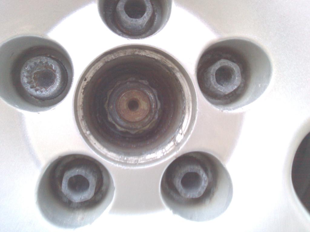

jamieg Posted July 21, 2008 Report Share Posted July 21, 2008 Oh my god I can't believe I'm here typing this up but I've got an A3 1.8T Quattro and I can't get the back wheels off to do some work, "no laughing please" I've removed all 5 pins/bolts but the b*****d wheel won't come off am I missing something here or what? Is it something to do with this bolt in the middle of the wheel? I've got no standard audi supplied tools for this bolt either. After removing the bolts I've given the wheel a real good tug and also a good bang on the inside of the tyre to un-wedge it to no avail. Sorry if this is a real thicko question but ............. it needs asking Link to comment Share on other sites More sharing options...
Dallan Posted July 21, 2008 Report Share Posted July 21, 2008 I can sympathise and empathise... a real bugger.... imagine trying to do this if you had a puncture in the rain at midnight in winter! The alloy wheel will have bonded iteself to the steel hub - oxidation/corrosion. You could try: continue to knock/chap the inside of the wheel rim with a heavy hammer - a block of wood against the wheel will protect it. Work round the circumference of the wheel. Try a kettle of very hot water over the centre section of the wheel - where the nuts go, and then the hammer/block of wood treatment. It will come... in the worst case, remove the centre cap/logo and try a large hub puller through the centre hole with the 'legs' gripping the spokes. You might want to wrap the puller legs with rag/tape to prevent marking the alloy. Best of luck. D. Link to comment Share on other sites More sharing options...
Dallan Posted July 21, 2008 Report Share Posted July 21, 2008 To continue.... when you are about to replace the wheel, give the mating surface of the wheel a coat of copper grease or similar high melting point grease to prevent it bonding with the steel hub in future. Give the hub a wire brushing around the holes for the wheel bolts. Expect to have to go through the whole performance with each of the other wheels should you decide to remove them. Let's know how you get on! D. Link to comment Share on other sites More sharing options...
jamieg Posted July 21, 2008 Author Report Share Posted July 21, 2008 Cheers Dallan for the replies much appreciated Well I've been going at it now since 6:30 and it for sure is not coming off without a heavy hammer "don't have one" will get one tomorrow and give that ago, I used all other methods you listed above but no luck, I had a small hammer typical indoor one but I don't think it's heavy enough to do enough to get it off. Link to comment Share on other sites More sharing options...

jamieg Posted July 23, 2008 Author Report Share Posted July 23, 2008 Cheers for your help guys, got a lump hammer at it last night and 15 minutes of banging away off it came very gingerly, what a f**king a*se of a wheel. Much appreciated. Link to comment Share on other sites More sharing options...
