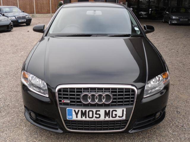

Posted 11 April 2009 - 12:04 AM
Hi
many thanks for that(wasn't expecting a response that quick!)
It is a b7 A4 1.8t s-line 2005 plate, and the dealer was adamant that the recommended cambelt change for this model is around 100k-120k..could this model have the chain type like you mentioned? is there a way of telling? and would i just be better taking it to my local audi garage for inspection? i want to be on top of repairs and maintainance for this solid set of wheels...many thanks again.....can't believe all this advice is for free??? Smashing!
