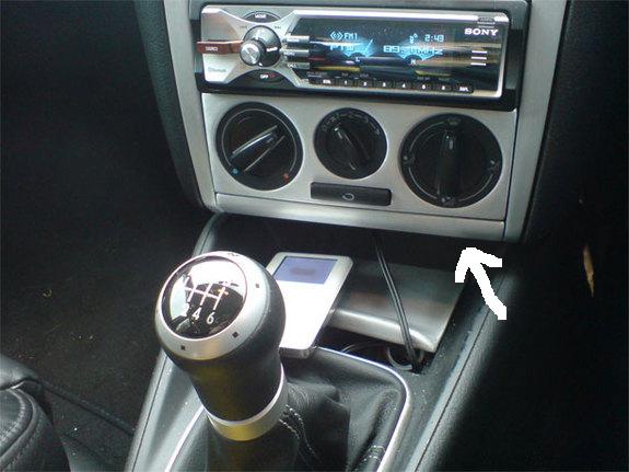

j14rka Posted April 29, 2009 Report Share Posted April 29, 2009 Can anyone please help i am trying to find my dianostic port ,i have a golf gti diesel 150bhp 2003 . I have looked under the climate control,glove box ,fuse box . Link to comment Share on other sites More sharing options...
shark_90 Posted April 29, 2009 Report Share Posted April 29, 2009 It's under the climate unit, there is a piece of trim covering it. Just feel underneath the trim and pull it forwards and off. As shown here: Welcome to TSN Link to comment Share on other sites More sharing options...
j14rka Posted April 29, 2009 Author Report Share Posted April 29, 2009 Thanks for the advice, under my climate control i have the gear console ,i have took the console out but i did not see the port ,i dont have the plastic cover you are talking about ,perhaps you can explain cheers Link to comment Share on other sites More sharing options...
mb Posted April 30, 2009 Report Share Posted April 30, 2009 Just pull the bit of plastic under the AC towards you & downwards - you will probably see a symbol on it confirming it is the right bit Link to comment Share on other sites More sharing options...
j14rka Posted May 1, 2009 Author Report Share Posted May 1, 2009 cheers mate you were right,thanks for your help i would never had found the port or the small panel many thanks Link to comment Share on other sites More sharing options...
