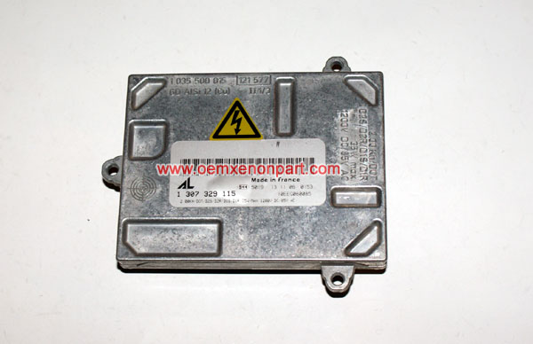

This problem is headlamp xenon ballast .
Because A4 B7 xenon system have two types part(ballast and bulb),if bulb is OK, then problem is ballast.
BTW B7 oem ballast like this ,Attached File  2006-2009-Audi-A4-S4-A3-RS4-OEM-Xenon-Ballast.jpg   35.43KB   49 downloads
hope can help some body.
