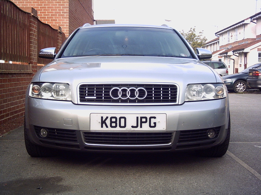

sorry for the delay ive been a little busy, firstly a B7 rear bumper will not fit as its the area around the rear lights that is different, ive been busy fitting a front sline lower to my original bumper and then adding a lower cupra r splitter, photos hopefully here
before
Attached File  frontold.jpg   263.32KB   20 downloads
after
Attached File  frontnew.jpg   226.2KB   22 downloads
the cupra r splitter part number is 1ML 805 903 and costs around £25 from seat including vat, worth the effort i think it took all day saturday and a couple of hours sunday to do trickiest part was getting my newly constructed grills to sit correctly.
the splitter took around 15mins to fit but i did have the bumper off the car. On the car it would probably take longer. i used bolts straight through the sline lower to attach it as i dont want it to fly off unexpectadly.
just got to source a rear avant lower with twin cut outs now, anyone have one for sale?
