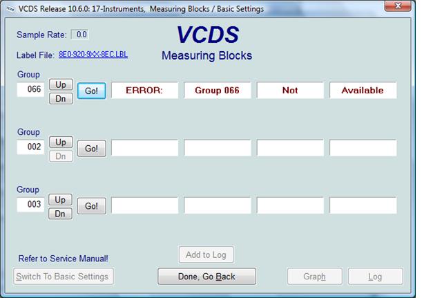

Hi all
I have just fitted Cruise control and DIS to my Audi A4 B7 following this guide http://www.vwaudiforum.co.uk/forum/showthread.php?52211-DIS-AND-CRUISE-RETRO-FIT-b6-b7 The DIS works 100% but the Cruise control does not work at all, when I hit the Cruise Stalk while driving nothing happens. I was thinking it may be a faulty Clutch Switch so according to this site, I done the following (http://www.wak-tt.com/vagcom/vagcomccbrakeclutch.htm
Select"01" Engine
Select"08"Measuring Blocks
Select Block"066"and GO
Display columns 2 and 4 show binary switch outputs from the Clutch/Brake pedals and the Cruise control stalk, when you press the pedals or operate the switch, the 0's should change to 1's or visa-versa.
The change indicates a working switch, if no change occurs you can isolate the failing switch
When I try to test it via Vag-Com I get a ‘Group 066’ not available (most likely my cheap EBay cable). I have also went through all the groups but can’t find anyone related to Cruise Control
Attached File  vag-com.jpg   33.64KB   15 downloads
Has anyone any ideas??
Thanks

Posted 24 October 2011 - 10:03 PM
After some messing about I got the Cruise Control System Group to show up on VAG-COM (cheap ass ebay cable, you get what you pay for)
01 Engine \ 08 Measuring Block and Selecting Group 006
When I hit the CC stalk up, down, left, right etc. the 'switch Monitoring' part (see screenshot) binary code changes from 0 to 1 at different parts of the number so I think that the CC is enable and the Stalk is working.
When I press the brakes the last two digits on the ‘Pedal Monitoring’change from 00 to 11. If I press the clutch nothing happens. I’m guessing that the next two digits should change but they are stuck at 11. Does this indicate a faulty clutch switch and is this way my CC is not working?
Attached File  group 006.jpg   38.91KB   13 downloads
Thanks for all your help!
