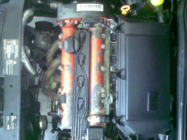

I have uploaded the top part where there are three sensors. There are two facing upwards and there is a single one which is green which is plugged in the head. Is the Camshaft Sensor one of them and CTS too?

Green one is the CTS.
I think the other 2 are camshaft timings sensors. Which one is faulty, you're guess is as good as mine.
