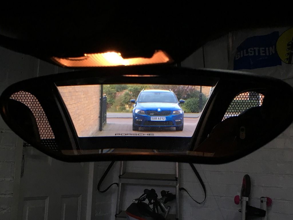

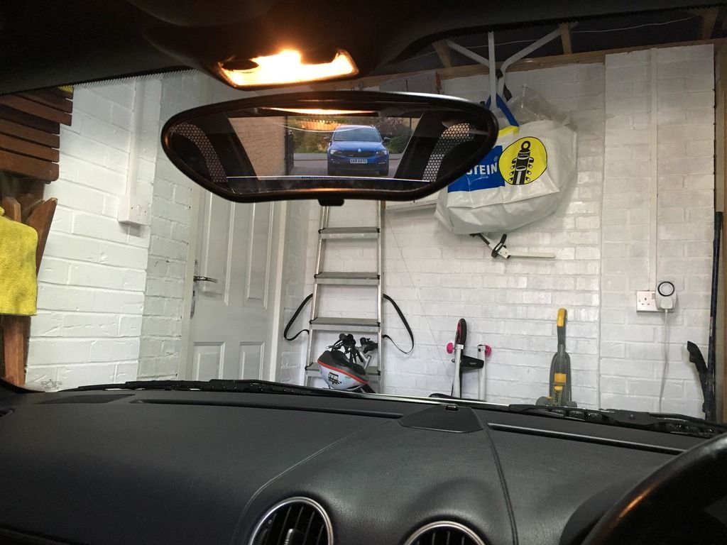

The riddle of the missing rear view mirror has been solved by the prompt arrival of a replacement from German eBay complete with the mounting button (and a little chunk of windscreen still attached to it).
2 minutes with the angle grinder had a nice smooth surface and I picked up some windscreen adhesive from Halfords too. £5 from Halfords or £2 delivered from eBay but as Evans Halshaw were paying I went with the instant option!
Dropped the receipts for the mirror and adhesive off at the garage this morning, they took copies and raised a cheque to be sent direct to me as well as furnishing me with a coffee to go. Very polite and friendly, left me with a good feeling about Evans Halshaw- even if the purchase negotiations were a bit protracted they've come good when it counts - sorting out little niggles.
Followed the instructions on the kit and a couple of minutes later, success:
Just checked now, a few hours later, it's not fallen off and I've moved it into the correct position so it must be stuck fast:

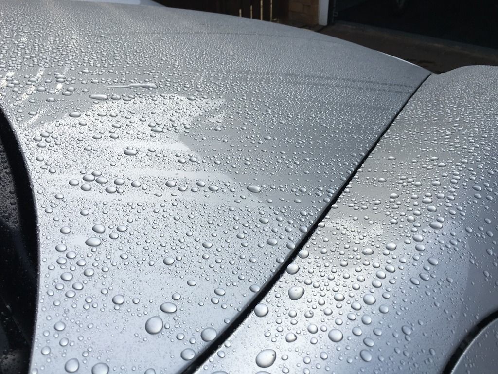

And a gratuitous beading shot from after I rinsed the roof off :) :

Great surface tension. Lovely beading  +++
Yup- considering it's a sealant and not a wax it's still bloody good.
Whatever happened to sheeting? (no not that)
I seem to remember being told* some years ago that beading was bad (some bollox about dust getting trapped in the beads or the beads acting as magnifying lenses and letting the sun burn the paint) and that you wanted something that allowed the water to sheet off instead.
*might have been one of those stupid yank infomercials selling snake oil (or polish in this case) that was probably flame proof too.

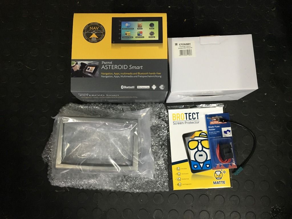

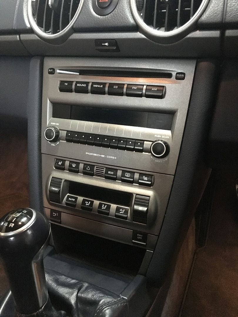

This little lot arrived:
Parrot Asteroid Smart, Gen1 Boxster/Cayman Double Din surround and fitting kit, FAKRA aerial adaptor, inline fuse and a Matt finish anti-glare screen protector for the Nav unit.
To replace the standard Porsche stereo with a 6-cd changer in the frunk:

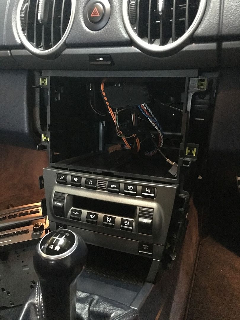

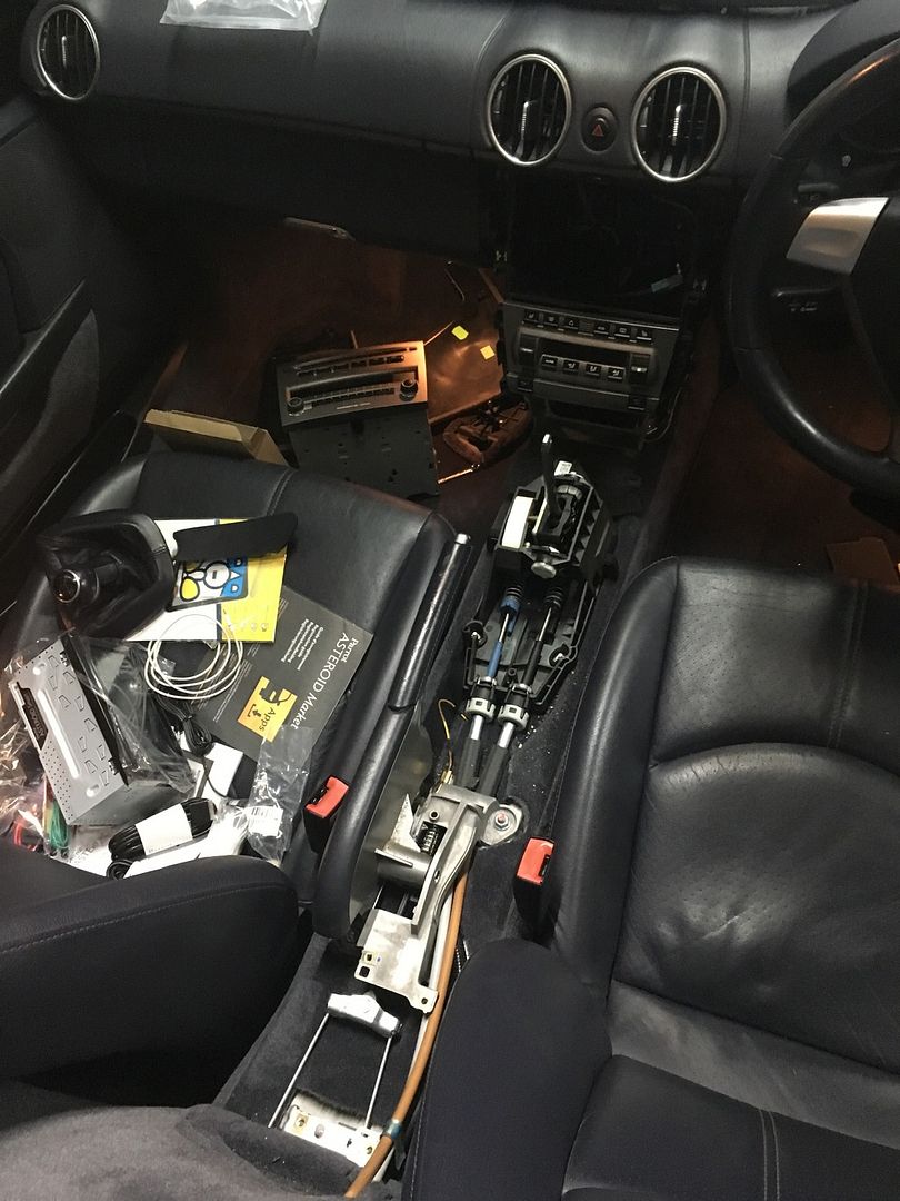

Side carpets and panels off and stereo unbolted and removed:

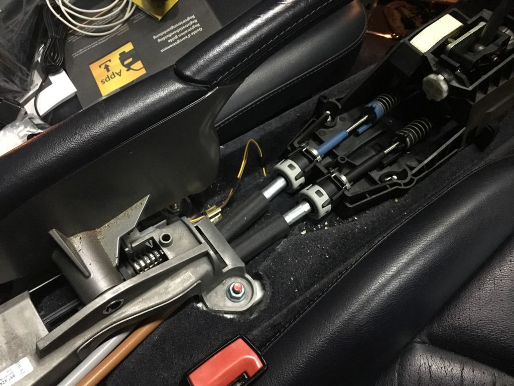

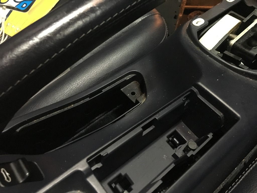

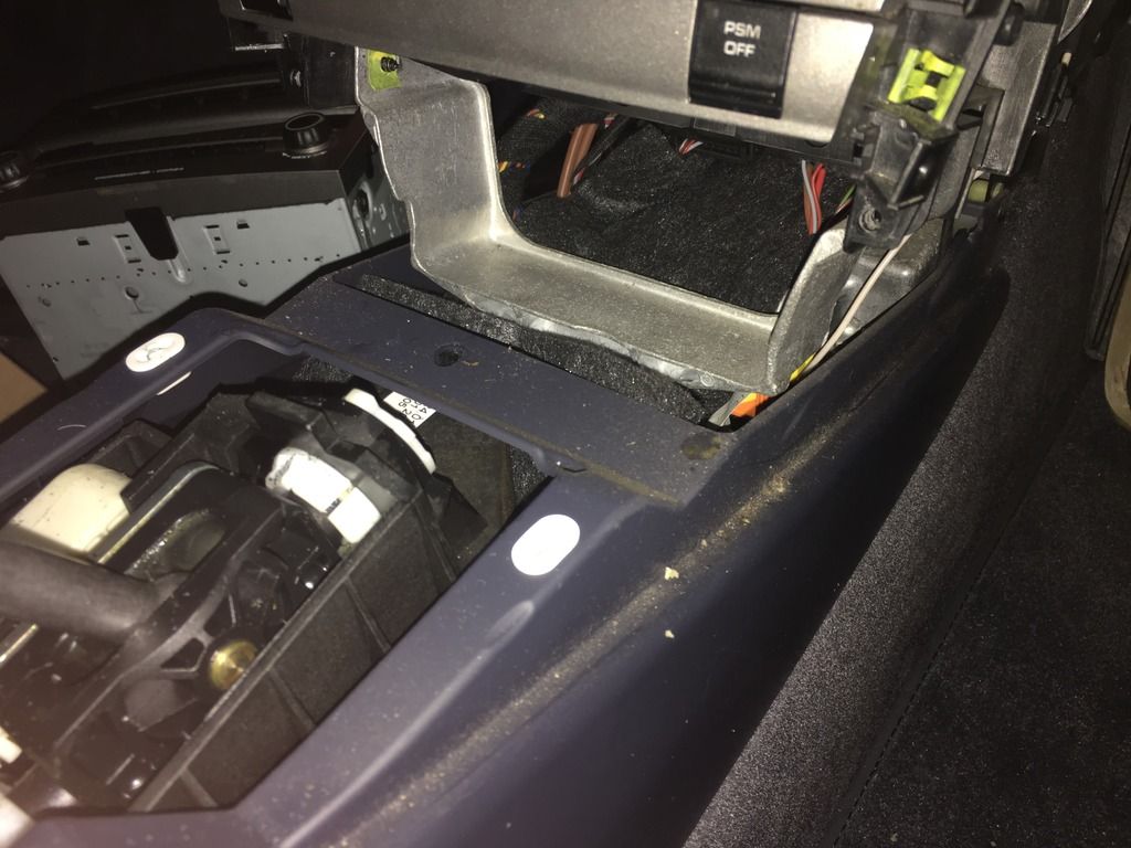

Decided that I wanted to route one of the phone cables to the glovebox and the other to the rear armrest, that meant removing the centre console, starting with the gearknob:
Just as well really as this revealed 10 years of grime:
I believe the phrase the kids use is "that escalated quickly":

What's with the superfluous 'E' on the Menue button of the standard Porsche unit?
Is it meant to give a clinical (not a criticism) German car a bit of 'flair' like in Italian cars that still label dials in Italian such as Olio, Benzina etc?
If so, it doesn't quite work. :roflmao:
It's always quite satisfying cleaning the years of dirt out of bits of the car that can't be seen, you'll know it's done!
No idea. But it's gone now.

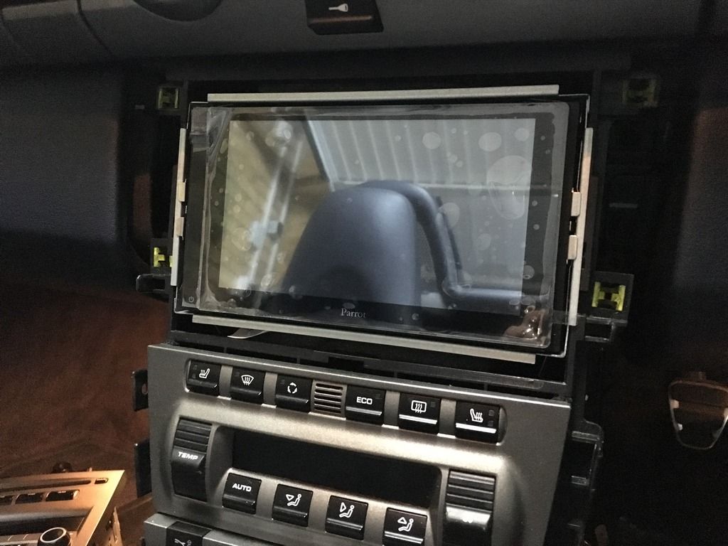

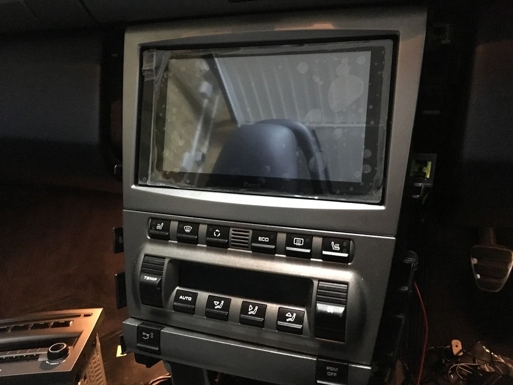

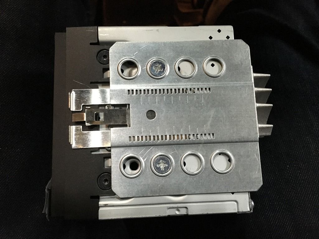

Several test fits and adjustments of a mm here and there before bolting everything down into place:
And all lined up nicely:
So clipped the surround into place:

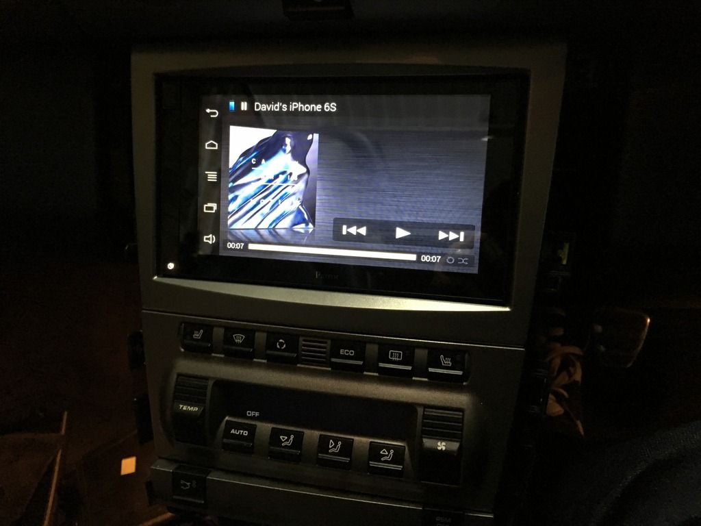

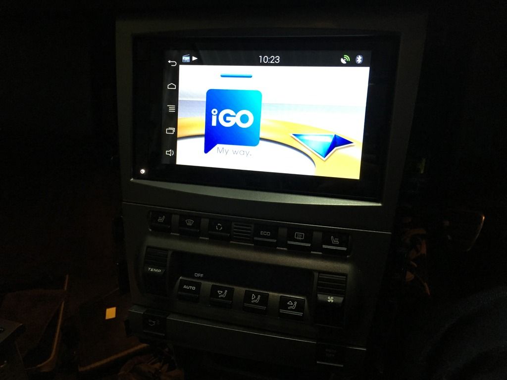

And all is good. From a brief play it's a very well featured unit. Lots of apps that can be downloaded and played with but straight out of the box the Nav is very capable, the radio interface is very clear and has auto scanned all the stations and the iPhone link for music etc is excellent too. Played about via Spotify but you can download the Spotify app onto the unit and this then gives you all the playlists and control that way so I'll be doing that when I've finished putting it all back together:
I paused it to take a photo of the music interface and it deleted all the song, artist, album info from the screen - left the cover art though:
2 people like this

Can you get those ugly Android controls to disappear?
Can't stand seeing them, they always bug me!
Looks like a nice bit of kit, certainly brings the car bang up to date.
The buttons are always there but I like that. The only physical button on the unit is the power button so the menu buttons being omnipresent brings standardisation to all the different screens and apps. I know that MrsEldavo will find it more intuitive that way too.
