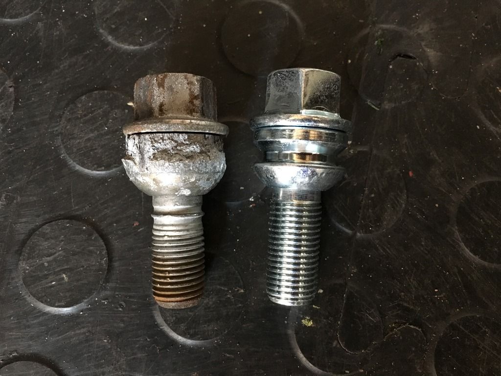

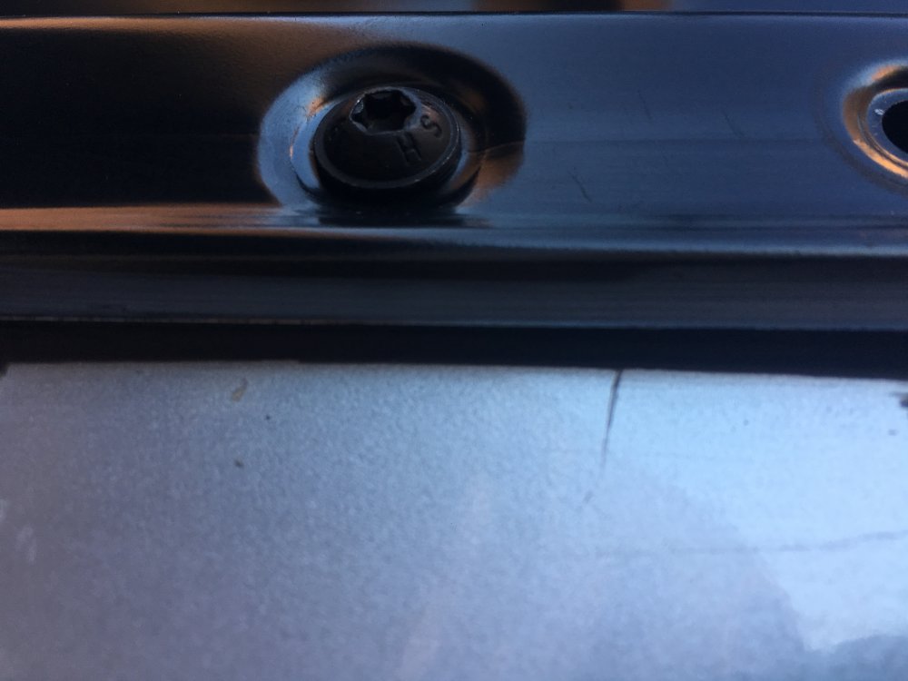

Anyhoo - ordered some replacement wheel bolts as I wasn't happy about how corroded the radius collars were.

Replaced those horrible corroded wheel bolts with some nice new ones too:

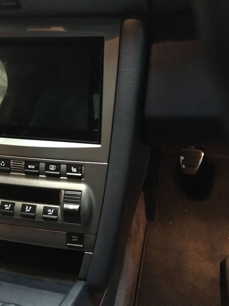

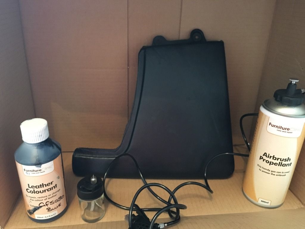

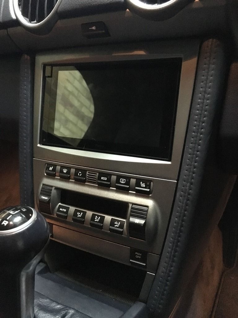

One of the available options on the car from new was an extended leather package. Part of this involved the replacement of the two vinyl covered panels either side of the centre console with stitched leather ones. These are not only easy to change but make a big visual difference as they're one of the main parts of the interior you see whenever you use any of the heating/nav/etc.

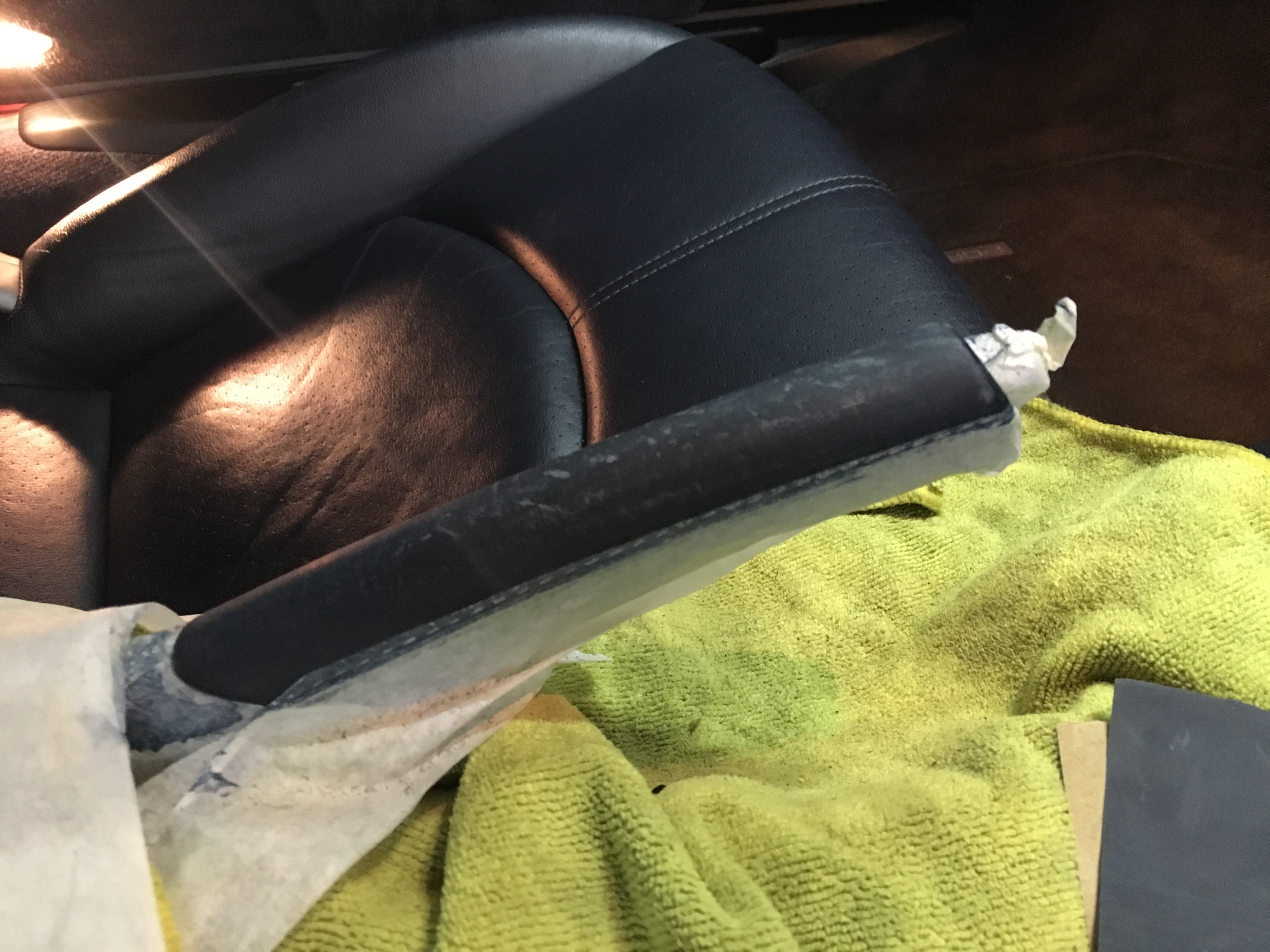

As luck would have it, a couple of panels popped up cheap on eBay as they were slightly damaged and also happened to be the wrong colour! The leather handbrake sleeve had some ring marks on it that I intended to repair with a kit from The Furniture Clinic so the arrival of these parts gave me a suitable test bed.
I paid about £65 for the leather repair kit, including a £10 charge to have the colour matched exactly to the existing leather rather than their off-the-shelf colour. As the company is local I took the gearknob to them and they used the gaiter to colour match from. The kit is more than sufficient to do the console panels, handbrake cover and give the seat bolsters a spruce up too.

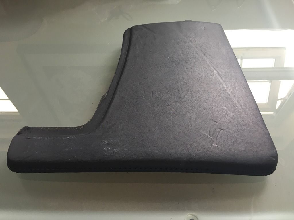

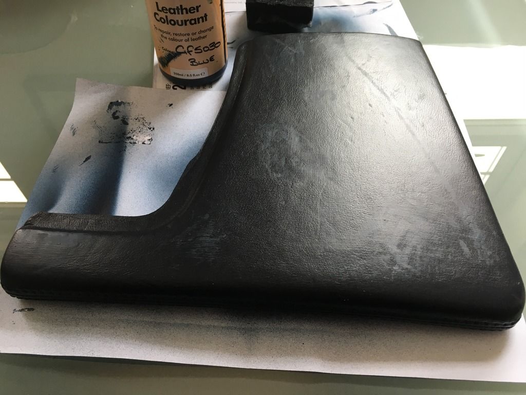

First thing first was to assess the panel, it was the darker of the two interior blue colours (I needed the lighter one) and had numerous indentations in it:
The first stages involved scouring the surface with a solvent and then alcohol cleaner to remove the protective coating and reveal the true state of play:

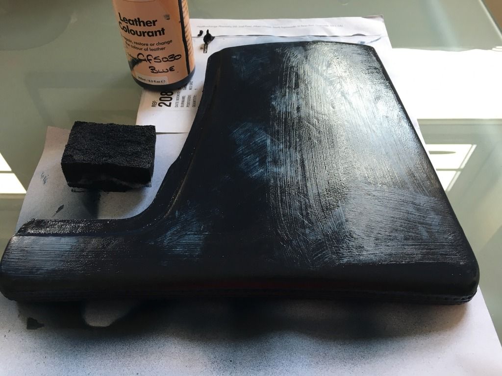

With that done, it was time to set about using the flexible leather filler on the indentations:

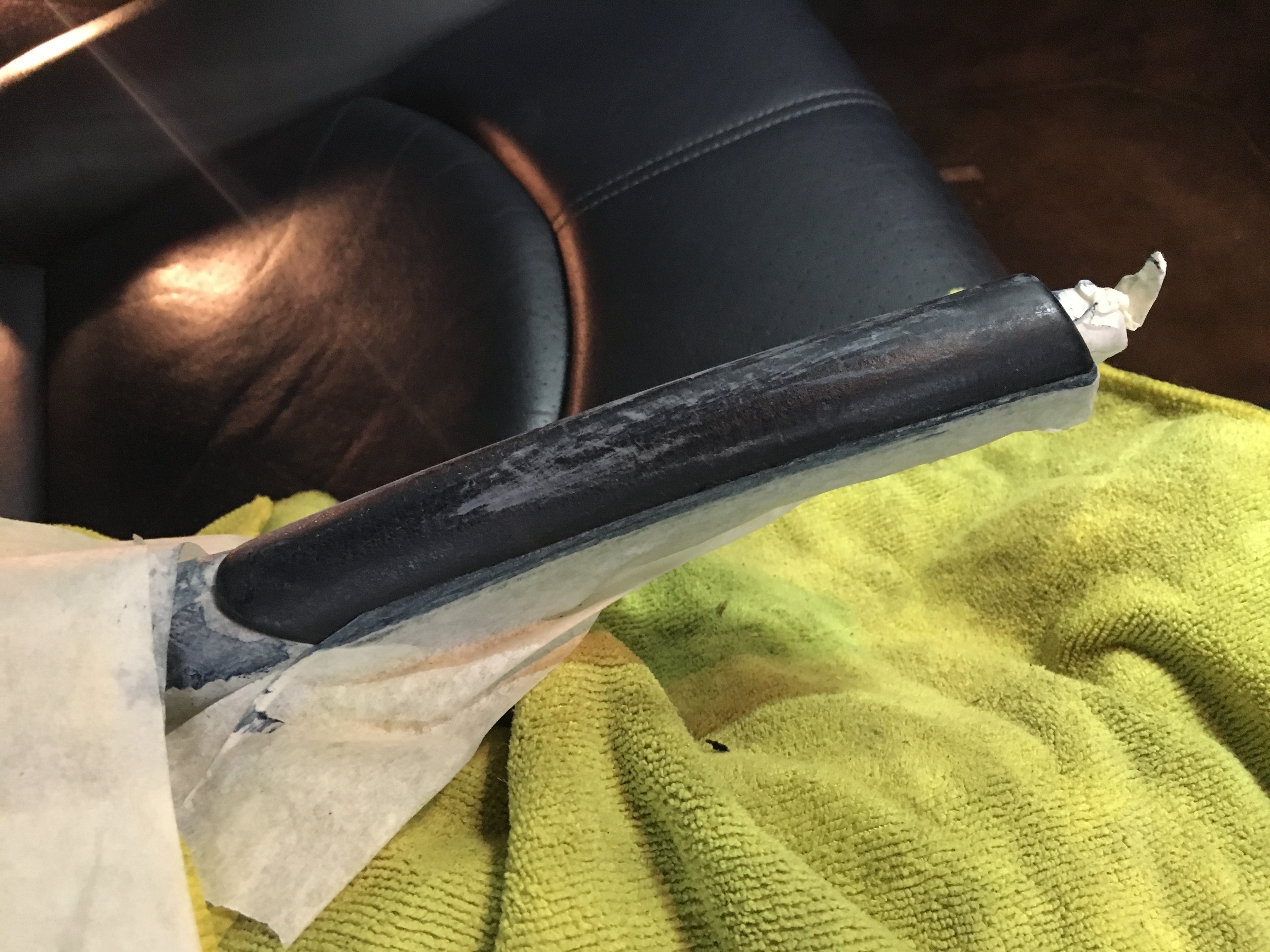

This was gently sanded back with 1200 paper and then a colour coat was sponged on to act as a base and to reveal any parts that were still uneven:
A bit more work needed:

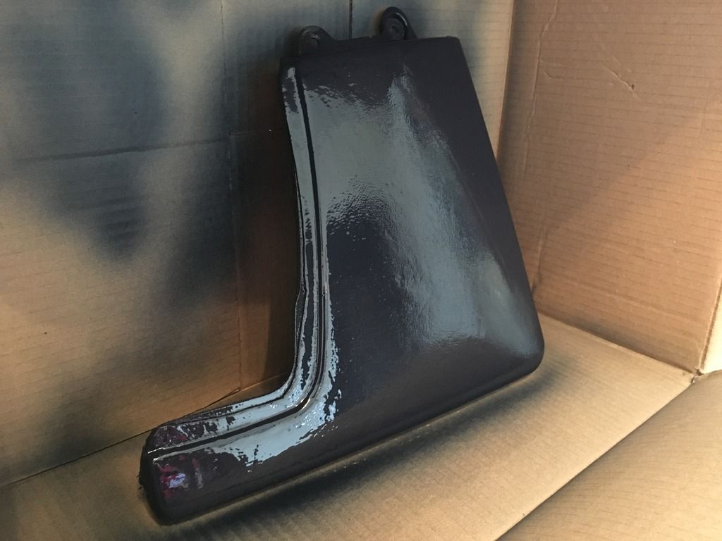

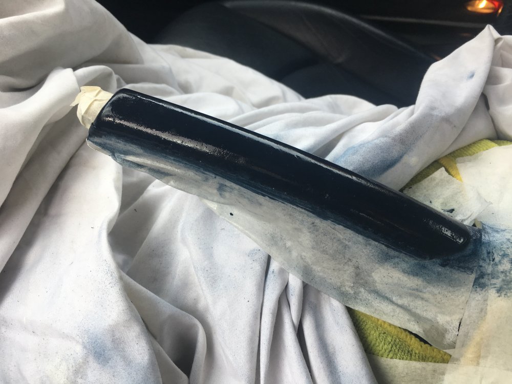

So another bit of filling, sanding and sponging necessary before I was happy with it and then onto my state of the art home spray booth:
Colour coat on and then a gloss finish sealant applied carefully as it is very thin so easy to get runs in it, still wet in the picture here - it's not THAT glossy, but it does show how smooth and uniform I got the surface:
Based upon the leather sample I'd been given a semi-matt finish to match the OEM leather so once the glossy sealant was dry I sprayed a light coat of this and when it dried I was left with this:

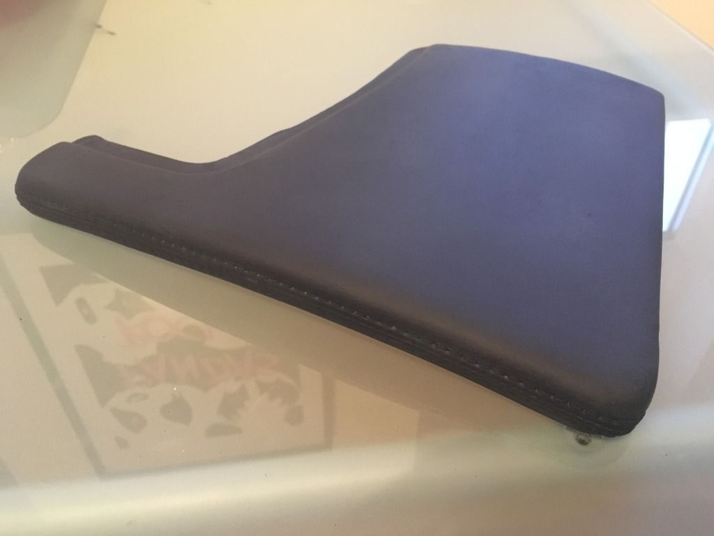

Off to the Garage and time to remove the vinyl-covered plastic:
To be replaced by the new part (and in true Blue Peter style, the other side was "one I prepared earlier):
Overall - very happy with how it came out and a nice visual upgrade to the car as well as being a relatively shallow learning curve for doing the handbrake and driver's seat bolster :)

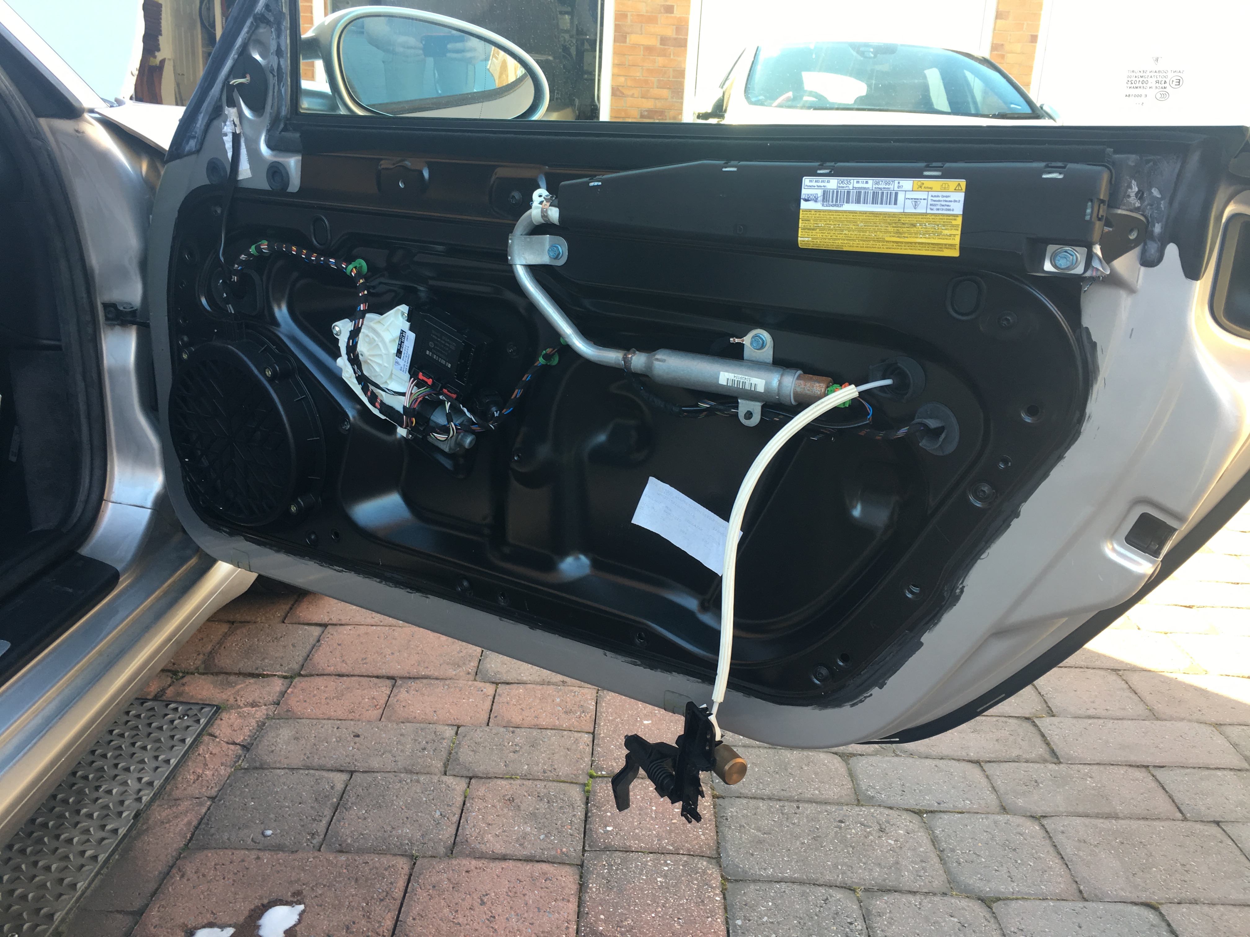

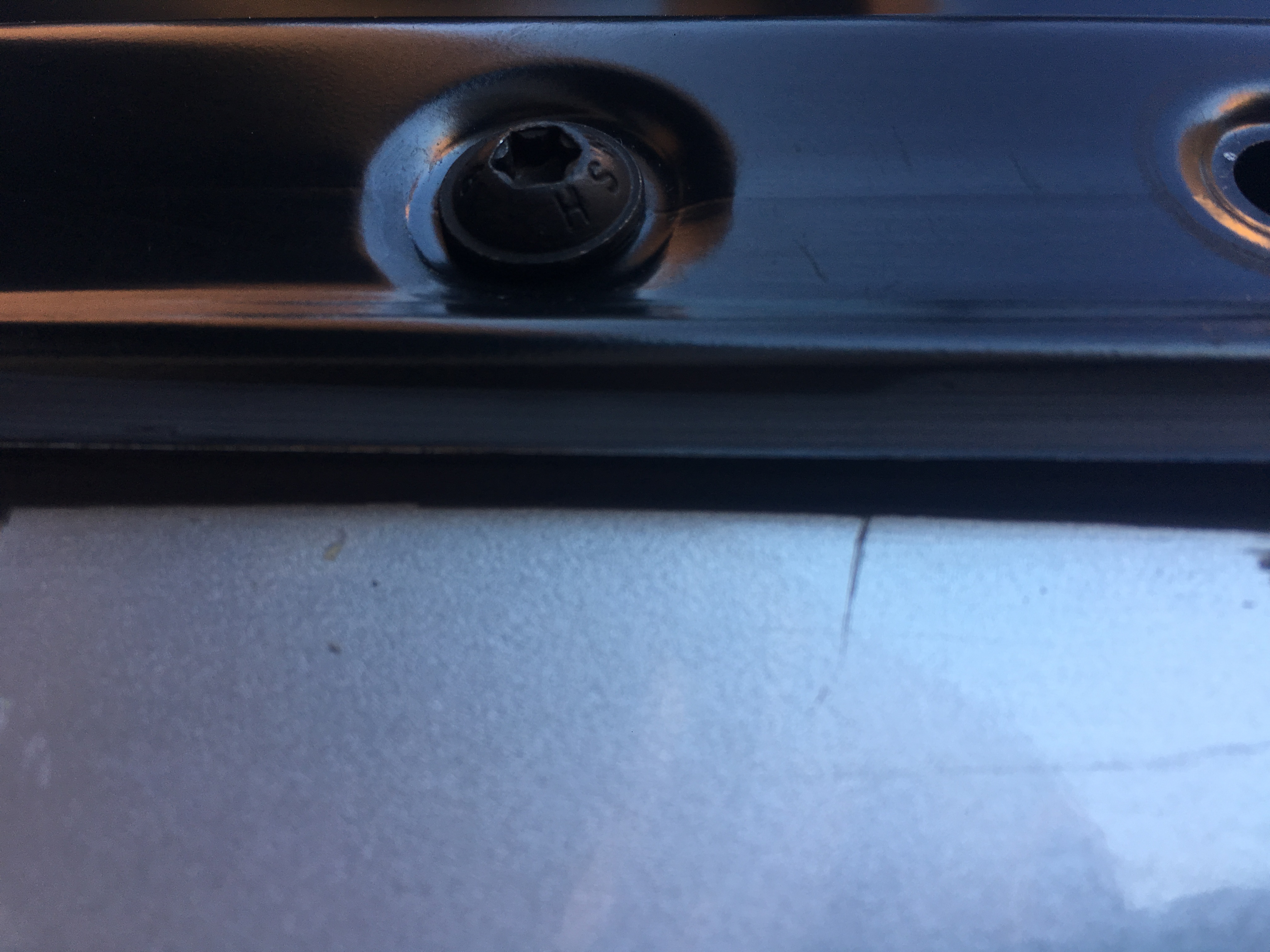

Since the 944 has been back, the Boxster has been kicked out of the garage and sits on the drive. I was rooting about in it last week sanding the handbrake down and respraying the leather sealant on it when I noticed the bottom of the driver’s door card was damp - below the armrest in carpet on the 997/987 cars just like the 996/986 ones.
I’d removed the door card last year to fit some of the extended leather parts - pull handle and armrest lid and I must have disturbed the water membrane. As it was, I didn’t really like the leather bits so took the doorcard off tonight when I got home from work. Changed the handle and lid over and had a look at the water membrane. It’s sheet steel with a foam gasket that sits against the door and when I’d previously removed the door card I’d pulled it away slightly at the bottom. A common issue according to t’internet and an easy fix with some flexible sealant too.
Door card back on, checked the tyre pressures, started her up (my god was it tappety from standing unused), roof down, a gentle trundle down the road with some heavy braking to clear the discs, up to temperature, a quick 15 minute blast round some favourite twisties and then home with her purring away quietly.

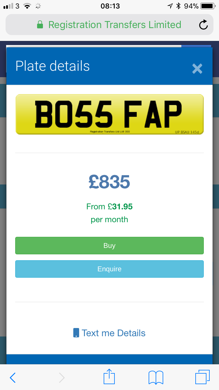

It niggles me that the 911 is FPA, not FAP <_<
1 person likes this
I found this for you Patently:
2 people like this
