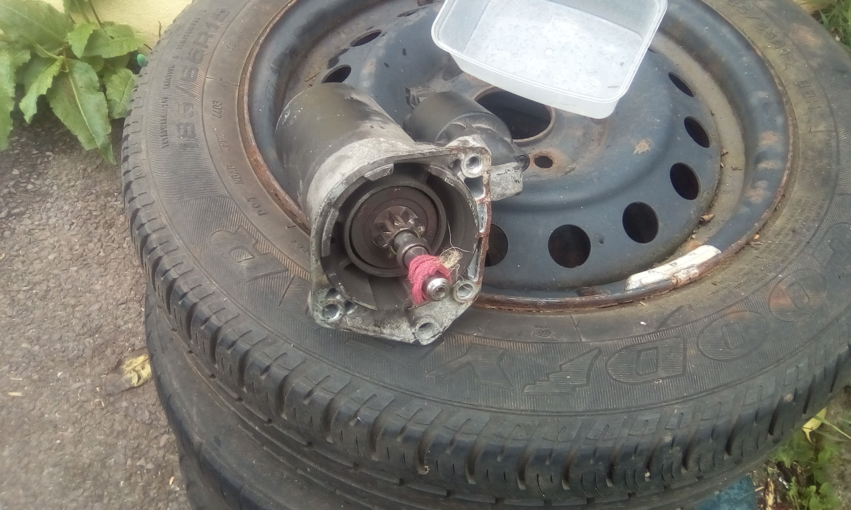

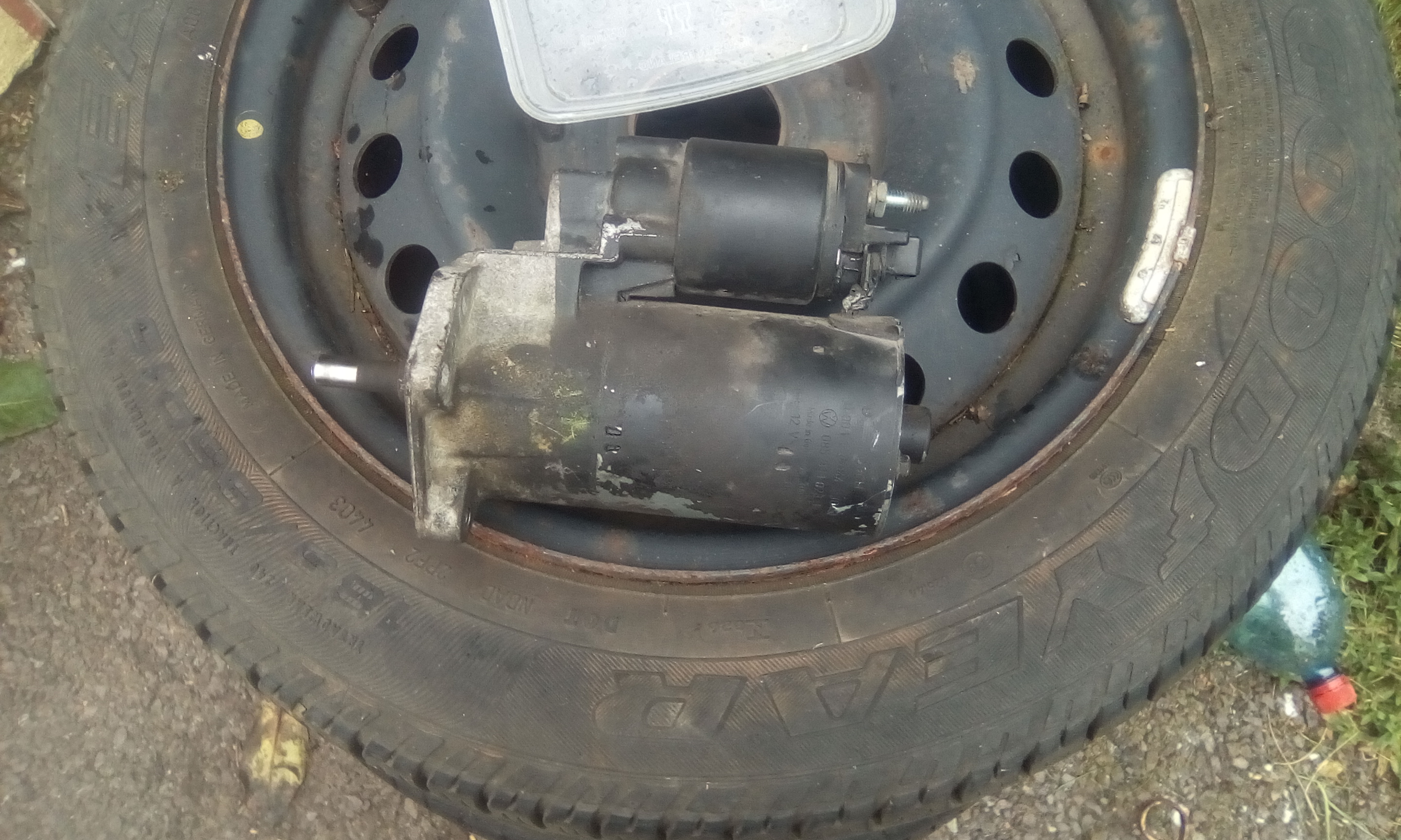

Hi just finished pulling the starter motor after putting a jumper on it with the jumper cable on the starter motor all it did was spin and didn't crank the engine pulled the starter motor and try it again the starter motor spin but the gear that caches the flywheel doesn't come out at all the shaft in the starter motor that has the gear on it is lose I mean I can move it around in a circular movement is it supposed to be able to do that the shaft is marked with a red cord
Sounds like you may have had the leads on the motor rather than the solenoid.
