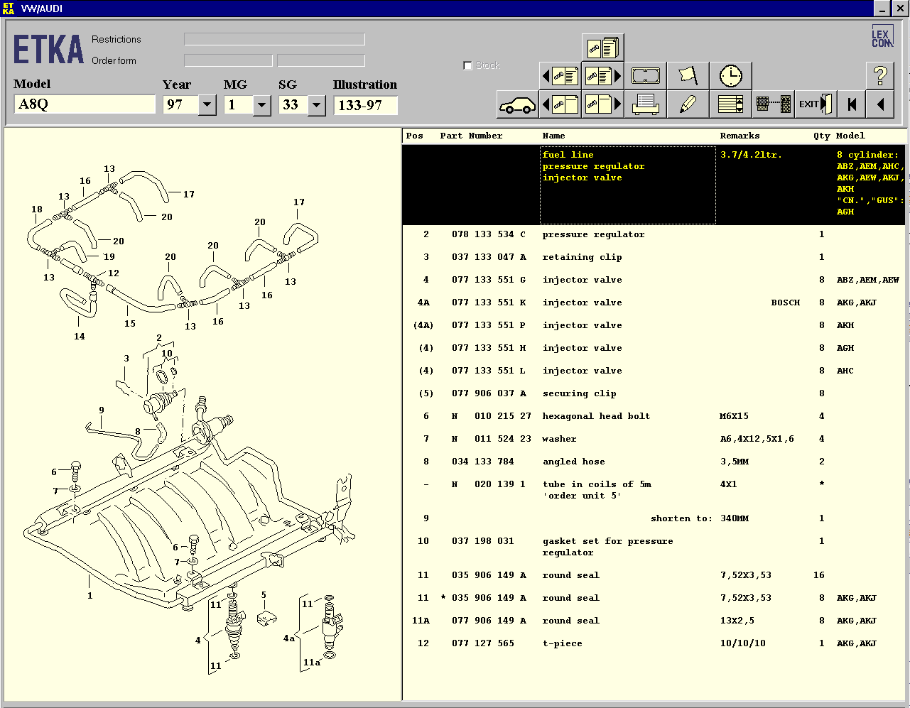

Sven Posted June 20, 2004 Report Share Posted June 20, 2004 Hmm, pressure regulator maybe? There's a few gaskets in there, which may be a bit old and brittle? That'd be my first thought. Next, injectors, fuel lines? Thinking the 'auto choke' may have something to do with it, since it dissapears when the engine is warmed up? Link to comment Share on other sites More sharing options...
SneakyMcC Posted June 21, 2004 Author Report Share Posted June 21, 2004 Thanks Sven. Sounds logical, aint got a Sven diagram so I know what I'm looking for have you? Link to comment Share on other sites More sharing options...

Sven Posted June 21, 2004 Report Share Posted June 21, 2004 For the time being, here's the Etka pic. Link to comment Share on other sites More sharing options...
SneakyMcC Posted June 21, 2004 Author Report Share Posted June 21, 2004 Thanks Sven Just needed to know roughly what the componets look like, before I go poking around. Thanks guys Course if there any other pics out there, please feel free to post Link to comment Share on other sites More sharing options...

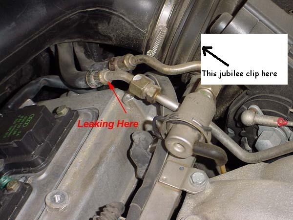

PaulW Posted June 21, 2004 Report Share Posted June 21, 2004 Don't you guys ever look at audipages? Check this article out. Normally this fitting will leak when it's very cold out....but it could also leak when it's warm. There is another very similar fitting under the air cleaner cowl just outboard of it. That one also leaks. People have cut the fittings out and just put hose clamps on them, which has worked sucssesfully. If you get the strong smell in the cabin, and it's not just after filling the tank up....then it's probably these fittings which are specific to pre face lift cars. Post face lift cars have different fittings. If it started leaking after a cam belt change, then it's probably because the mechanic was leaning on them, it's hard not to do when putting the cam locks in place in the back of the motor. Then the fittings will get deformed internally and start leaking. Look for the white residue on the lines and if you see it, it's leaking....guess where it falls on? The exhaust manifold! You don't want that. Check it out and tell me what you find. pw Link to comment Share on other sites More sharing options...
SneakyMcC Posted June 21, 2004 Author Report Share Posted June 21, 2004 Top man PW. How did I know you come up with a gem like this This might give audia8s2 and I some come-uppence at the stealer that fit the new cam belts (yeah right) Link to comment Share on other sites More sharing options...

SneakyMcC Posted June 22, 2004 Author Report Share Posted June 22, 2004 Had a rummage under the bonnet (fanx 4 the pics guys) this evening. Could find no obvious marks as you described, Paul, but found that part of the think pipe from the airbox to the induction system(?) was not seated properly and the jubilee clip had not been tightened. I think that the wide pipe was barely seated on the underside. I was unable see or feel down there but looking at the angles, I’d guess it wasn’t. Reconnected now so fingers crossed. Please attachment... Link to comment Share on other sites More sharing options...

SneakyMcC Posted June 29, 2004 Author Report Share Posted June 29, 2004 Well, it's been a week since I put that hose (part of the induction system) back on. Apart from the very next morning (wife said she thought she could smell fuel, but from the car in front ) we've had no smell of petrol Prolly still to soon to party, but I'm getting pretty close to shouting yippeeeeeeeeeeeeeeeee! Link to comment Share on other sites More sharing options...

SneakyMcC Posted July 2, 2004 Author Report Share Posted July 2, 2004 [ QUOTE ] Well, it's been a week since I put that hose (part of the induction system) back on. Apart from the very next morning (wife said she thought she could smell fuel, but from the car in front ) we've had no smell of petrol Prolly still to soon to party, but I'm getting pretty close to shouting yippeeeeeeeeeeeeeeeee! [/ QUOTE ] Am I tempting fate by saying "still no smell of fuel" Link to comment Share on other sites More sharing options...
