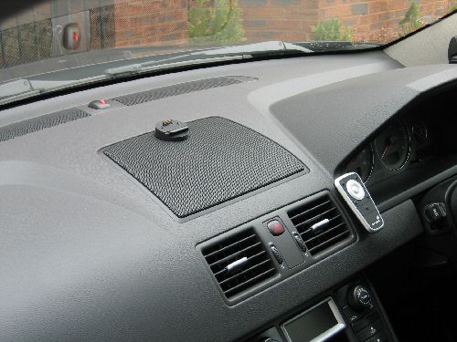

a4tdi130 Posted June 24, 2005 Author Report Share Posted June 24, 2005 Photo 1 : The TomTom mounted on the dash Link to comment Share on other sites More sharing options...

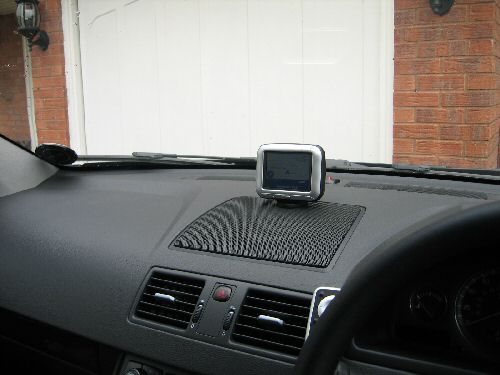

a4tdi130 Posted June 24, 2005 Author Report Share Posted June 24, 2005 Photo 2 : Another dash mount shot Link to comment Share on other sites More sharing options...

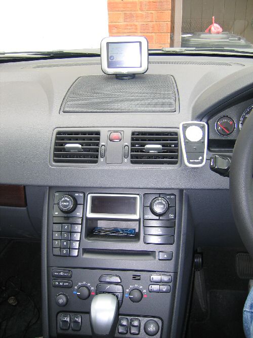

a4tdi130 Posted June 24, 2005 Author Report Share Posted June 24, 2005 Photo 5 : View from the side (ish!) Link to comment Share on other sites More sharing options...

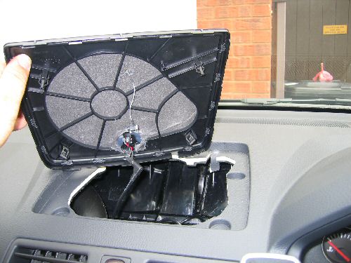

a4tdi130 Posted June 24, 2005 Author Report Share Posted June 24, 2005 Photo 6 : Underneath the speaker grill (who cares what it looks like if you can't see it!) Link to comment Share on other sites More sharing options...
a4tdi130 Posted June 24, 2005 Author Report Share Posted June 24, 2005 Photo 7 : This is what's left of the mounting bracket, and what it looks like with the TomTom unplugged from the mount. Link to comment Share on other sites More sharing options...

Botang Posted June 24, 2005 Report Share Posted June 24, 2005 Youve lost me a bit with regards the phone. Its bluetooth for handsfree but the microphone is built into the base if I am reading it right. So on the way you have mounted it is the microphone stillin the base or have you cut it appart and installed it elsewhere? The computer installation is almost complete by the way Link to comment Share on other sites More sharing options...
a4tdi130 Posted June 24, 2005 Author Report Share Posted June 24, 2005 Yep that's correct, its bluetooth handsfree but the mic is built in to the (BIG!) base. On my install, the microphone has been taken out of the base and trailed off underneath the speaker grill. If you look on photo #6, the runaway wire going "upwards" on the photo is the microphone Looking forward to seeing some pics of your PC install Link to comment Share on other sites More sharing options...

a4tdi130 Posted June 28, 2005 Author Report Share Posted June 28, 2005 [ QUOTE ] Excellent job on the install. Just looking for a little more info on the Handsfree part of it (already convinced by TomTom software). Where have you put the microphone? Have you compared the quality of calls made using this to a dedicated handsfree kit? I've never been impressed by non-hardwired hands free kits before. How loud is the speaker on it, is there any echo etc. Questions, questions...... [/ QUOTE ] Like Scoob said, it's excellent quality. I had somebody else sit in the car whilst I phoned them and it was better than the nokia bluetooth kit with external mic that I had installed before hand. The speaker is louder aswell, perfectly usable whilst doing 70 on the motorway. The microphone on my install is placed at the front of the speaker grill - have a look at photo number 6 again carefully and you can see the mic wire running "upwards" - the mic is tiny and is on the end of this. Link to comment Share on other sites More sharing options...
