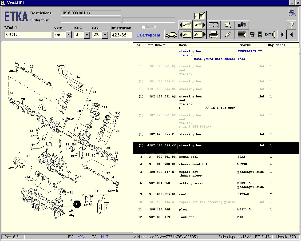

from what I hear your better off leaving it alone unless it gets very bad. The stealers seem to be fitting standard mk5 racks instead of gti racks.
As I understand it the racks are the same, each rack has 5 possible settings for assistance etc
I agree with Barry. If it works don't mend it! At least, not until the issue has much more known about it.
