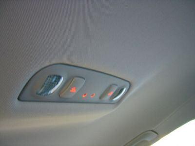

the911sc Posted February 12, 2006 Report Share Posted February 12, 2006 OK, So I am going to have a go at the rear ambient lighting!. Got the unit off today and had a good poke around, found the lighting feed wire(switched with the lights). Going to have to drill holes and use super glue to fasten the module in the rear unit. There is space but some soldering is also required to pick up the right feed. Will post pics when(if!) done... Link to comment Share on other sites More sharing options...

Avus_Bub Posted February 13, 2006 Report Share Posted February 13, 2006 [ QUOTE ] OK, So I am going to have a go at the rear ambient lighting!. Got the unit off today and had a good poke around, found the lighting feed wire(switched with the lights). Going to have to drill holes and use super glue to fasten the module in the rear unit. There is space but some soldering is also required to pick up the right feed. Will post pics when(if!) done... [/ QUOTE ] Yeah, took my rear lamp out last night. I've cut the OE front LED down so it'll fit inside the lamp unit. Now I've got to drill the holes..... If I get time I'll finish it off tonight............. BUB Link to comment Share on other sites More sharing options...
the911sc Posted February 13, 2006 Report Share Posted February 13, 2006 he he ... may be i'll wait for you then bub!... I am not sure I need to cut the unit thoigh... There's a big gap/space in the rear unit ? Link to comment Share on other sites More sharing options...

the911sc Posted February 14, 2006 Report Share Posted February 14, 2006 there is no such thing as ambient lighting in the rear; its a diy job, and yes the leds probably will be all over the place!. To be honest, looking at the module, there is nothing stopping you using standard bright led's in s casing with the in line resistor.. would probably be cheaper overall too.. Link to comment Share on other sites More sharing options...

Avus_Bub Posted February 14, 2006 Report Share Posted February 14, 2006 [ QUOTE ] there is no such thing as ambient lighting in the rear; its a diy job, and yes the leds probably will be all over the place!. To be honest, looking at the module, there is nothing stopping you using standard bright led's in s casing with the in line resistor.. would probably be cheaper overall too.. [/ QUOTE ] I'm on the case '911 I thought about doing a full DIY job but thanks to Nelson we now all have the part number for the real thing. At least you know they should last and it's only a tenner..... If you look at the LED module one goes straight down and one is at a slight angle, I'm going to set the angled one to shine to the rear. I think they'll be fine. Should look OEM like this............ Now I've just got to mark and drill the holes! BUB Link to comment Share on other sites More sharing options...

Avus_Bub Posted February 16, 2006 Report Share Posted February 16, 2006 Drilled my unit last night - I've just got to perfect the fitting of the LED's and I'll post a pic... Looks pretty good BUB Link to comment Share on other sites More sharing options...
Avus_Bub Posted February 16, 2006 Report Share Posted February 16, 2006 [ QUOTE ] Drilled my unit last night - I've just got to perfect the fitting of the LED's and I'll post a pic... Looks pretty good BUB [/ QUOTE ] Now fitted and working - HERE BUB Link to comment Share on other sites More sharing options...
