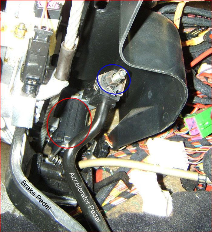

Okay, here we go, a pic of the FBW set-up in the Audi 80 TDi.
Basicaaly, in the pic the red circled object is (assumed) the Potentiometer as its connected to the mech at the top of the accelerator pedal by a short (2") rubbery rod. The connection can be adjusted by the nut (blue circle) at the end of the mech.
When you press the pedal it pulls on the rod which pulls the silver mech in a arcing motion centred around the gold nut at the top of the p/omiter.
I must have made about 4 or 5 complete turns of the adjsuter nut, but it didn't seem to take up any slack. I'm going to run the car to work (70 mile round trip) for a few days and see if I notice any difference. If not then it may be a case that the rubbery rob is expanding when the pedal is pressed as the silver bit its connected to it very hard to turn by hand and so I guess the tension on it is quite high.
I did adjust it too much and I could feel a stop against the pedal which I could go past if I pressed really hard, kind of a dull thud and then about 5mm more movement, but I guessed I'd gone too far so I backed it off until I could n longer feel this, so I think I'm at max adjustment.
Its a doddle to get to, just undo the few 8mm bolts holding the under panel on, pop you head down in the foot well and its about 6-8" up inside, easy to see and with a torch easy to adjust.
