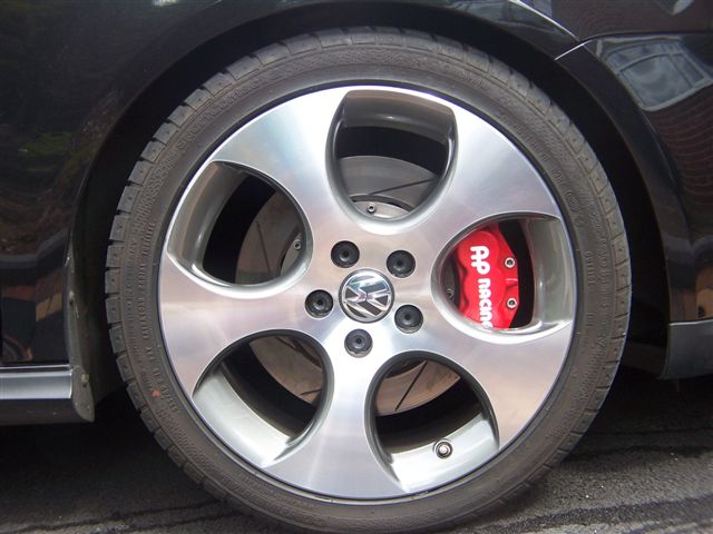

RedRobin Posted November 13, 2006 Report Share Posted November 13, 2006 Whereas the OEM disc brakes are very good, the aftermarket big brake kit by AP Racing (owned by but run independently from Brembo) are imo outstanding. I've had the advantage of driving over 2,000 miles on German Autobahns and now about 400 miles on UK roads including twisties. All in both dry and very wet conditions. The brake pedal now feels much more directly responsive but there is absolutely no snatching or sacrifice of smoothness. The stopping power is greatly and very noticeably increased, regardless of speed. I've tried heavy braking on a clear stretch of dry Autobahn from 130 mph and was gobsmacked how quickly and evenly my speed was reduced, and it's the same at lower speeds. I'm sure that my KoniFSD and Eibach springs and Anti-roll bars are contributing. The weight per corner of the OEM brake kit is 15.10 Kg but the AP kit is only 10.6 Kg, yet the disc is a larger diameter and is thicker. Driving with these brakes inspires confidence in all braking circumstances. My particular set are designed by AP Racing for fast road use and track days. They fit both 17s and 18s but if you have a front tyre puncture you'll have to also additionally swop it with a rear wheel because the thin spare wheel won't accommodate the brake kit. AP Racing design and produce brakes for the Bugatti Veyron, and brakes and clutches for most of the major F1 teams, so they know what they are doing. I had the privilege of one of their Senior Race Engineers wanting to get his hands dirty and allowing me to be there all the time while he fitted my brakes. The consideration and attention to detail that these guys put into their products is impressive. Cleaning the calipers (4-pot) is a bit tricky because the alloy wheel always covers part of it and tolerances are much tighter. Link to comment Share on other sites More sharing options...
petsy Posted November 13, 2006 Report Share Posted November 13, 2006 nice writeup Red and, by golly, those discs do look the business. I am actually wondering if that disc should be on the other side of the car judging by the AP photo of this Subaru regarding the grooves orientation. btw does AP reccomend the 4 pot vs the 6 pot for the GTi? Link to comment Share on other sites More sharing options...
GTiMK5 Posted November 13, 2006 Report Share Posted November 13, 2006 [ QUOTE ] I am actually wondering if that disc should be on the other side of the car judging by the AP photo of this Subaru regarding the grooves orientation. [/ QUOTE ] The callipers on Reds are mounted on the front of the discs and on that Scooby they are on the rear, hence the reason why. Link to comment Share on other sites More sharing options...
petsy Posted November 13, 2006 Report Share Posted November 13, 2006 hmm, isn't the whole idea of the grooves is to vent the brake dust and hot gases to the outer margin of the disc? as it is, the dust when the car is moving forward and braking is being directed to the inner part of the disc, not the most efficient. Additionally, I can't see why the placement of the calipers (front or rear of disc) should have a bearing on the orientation of the grooves as the direction of rotation remains the same. I'm happy for anyone to chip in and educate me if my basic understanding of this is incorrect... Link to comment Share on other sites More sharing options...

RedRobin Posted November 13, 2006 Author Report Share Posted November 13, 2006 [ QUOTE ] hmm, isn't the whole idea of the grooves is to vent the brake dust and hot gases to the outer margin of the disc? as it is, the dust when the car is moving forward and braking is being directed to the inner part of the disc, not the most efficient. Additionally, I can't see why the placement of the calipers (front or rear of disc) should have a bearing on the orientation of the grooves as the direction of rotation remains the same. I'm happy for anyone to chip in and educate me if my basic understanding of this is incorrect... [/ QUOTE ] ....I'm afraid that I don't know the answer to this and your logic seems sound. I have put my trust completely in AP and the Senior Engineer who fitted them. I'm certainly keen to know that my installation is as it should be. Functionally, the brakes are awesome so I don't imagine there has been a mistake. Link to comment Share on other sites More sharing options...

RedRobin Posted November 13, 2006 Author Report Share Posted November 13, 2006 [ QUOTE ] hmm, isn't the whole idea of the grooves is to vent the brake dust and hot gases to the outer margin of the disc? as it is, the dust when the car is moving forward and braking is being directed to the inner part of the disc, not the most efficient. Additionally, I can't see why the placement of the calipers (front or rear of disc) should have a bearing on the orientation of the grooves as the direction of rotation remains the same. I'm happy for anyone to chip in and educate me if my basic understanding of this is incorrect... [/ QUOTE ] ....Here is a pic of SiBurt's AP brake kit - Exactly the same as mine - and his looks the same as mine re grooves etc. Link to comment Share on other sites More sharing options...
