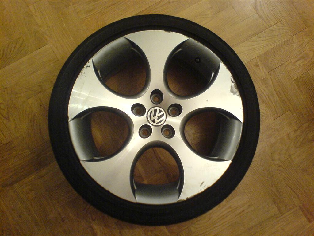

In short, I recently purchased a set of the 18" alloys to replace my 17" ones from eBay. I got them for what I thought was a decent price but now that I've received them and inspected them, I'm somewhat disheartened to see the amount of damage that's been caused by kerbing (imagine the entire outer edge of every alloy being scratched and chipped and you'll have a pretty decent idea). The seller did mention that they were scratched and need refurbishing but they didn't look too bad in the pictures mad.gif.
Anyways, first of all I want to be certain that I've got the genuine article here. I've read that there's a part number of 1K0601025AH1 for these alloys but I can't find this engraved anywhere on the alloys. Is there a way I can check that they are genuine ones?

How are you able to tell whether they're genuine or not? Bit of a daft question sorry but are you checking the attached picture or the link? (the link is to a photo of a genuine one that I've pinched from a another thread for reference, and the attached picture is of one of the one I have, sorry if this wasn't clear in my original post).

Looking at your attached picture instead of the link I would say yours are replicas.
There should be a BBS stamp on the inside somewhere.

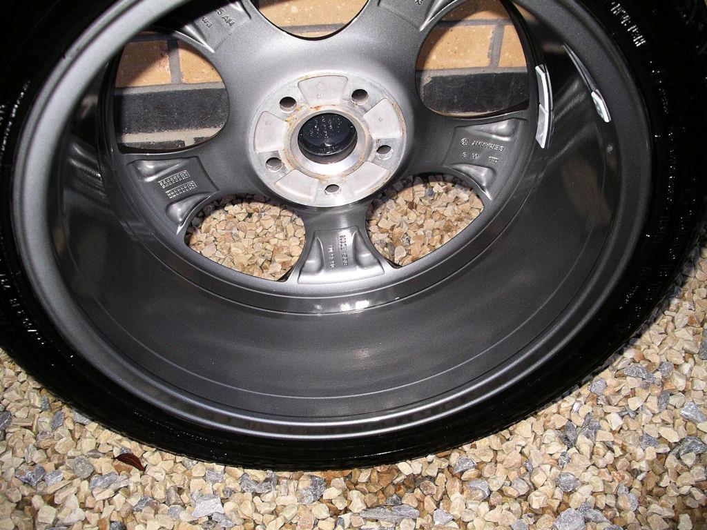

Here is a picture of a genuine Monza II wheel – from the inside. As you can see from the picture there is stamps and lettering/numbers on every spoke.
JD
I'm starting to wonder now?!?!?!? I've posted a face on pic of mine for comparison and they do look very similar but yours dont seems to have such a large edge to the rim. (pos the curbing) Suppose your answer is whether or not you can see the vw and bbs stamps as in the above post.
Something i remember about the replicas were that they appear much closer to chrome than the machine polished look of the oem's
Yours
Mine
You can easily check if they're genuine by looking at the back.....there should be a BBS number...something like BBS RD 305 (although the 305 may be 278 or another no.)
There should also be a "GERMANY VW" logo and the part number on them as well as shown above.
Have a look at the photos above and in the links below and you can see where these are located :-
linky 1
linky 2
Thanks all for you help, I'm quite certain that I've ended up with replicas now. Quite gutted that for about another £150 more I could've bought a brand new set of these replicas wheels with new tyres and all. Anyway, lesson learnt and guess it could've been worse blush.gif
I've had a look on the insides and the spokes look significantly different and the colour is a plastic grey colour rather than being shiney. No signs of BBS or a VW logo.

Apart from checking stampings on inside, the first pic in Ryan's post is replica and the second lower pic is genuine.
I'm on a borrowed Mac (without Photoshop) and so can't pen mark the area - Check the differences where the open 'horse shoe' shapes meet the rim....There's a change of 'level' on the replicas (drops down a millimetre or two).
Just take your eye on a view all around the rim edge circumference by the tyre - It's then obvious.
