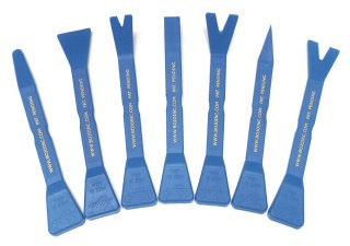

dogbucket Posted March 22, 2008 Report Share Posted March 22, 2008 one thing I learnt which is not fully explained in those guides: is when removing the top vent (the surround of which extends halfway down the MFD). After releasing the top clips, push in and up with your thumbs on the two side strips either side of the screen just above the joint to release the clips (which go under the bottom fascia section around the heater controls). Also use a plastic tool like those plastic mixers that come with body filler etc to unclip the trim. Screwdrivers will mark and mangle them big time. Link to comment Share on other sites More sharing options...

dogbucket Posted March 22, 2008 Report Share Posted March 22, 2008 It really isnt that hard. But if you plan to do other trim removal jobs invest in a set of 'Bojo' tools. Well worth it. Link to comment Share on other sites More sharing options...
ludwig Posted March 25, 2008 Author Report Share Posted March 25, 2008 dogbucket, thanks for this. <It really isnt that hard.> That's given me more confidence to have a go. <...invest in a set of 'Bojo' tools.> Yes I will consider doing that. They look very useful. Thanks again, ludwig Link to comment Share on other sites More sharing options...
