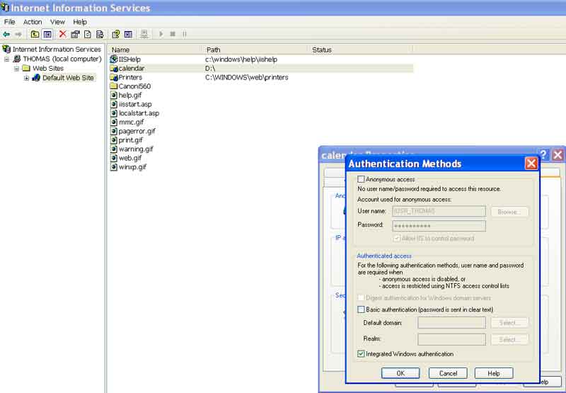

Mac Posted June 29, 2008 Report Share Posted June 29, 2008 Have you got authentication turned on? Quote Link to comment Share on other sites More sharing options...
Waylander Posted June 29, 2008 Author Report Share Posted June 29, 2008 yes and I disabled anonymous authentication. Here is a snapshot of my options [as per images] I am certain is it just some setting I have not done properly... Quote Link to comment Share on other sites More sharing options...
