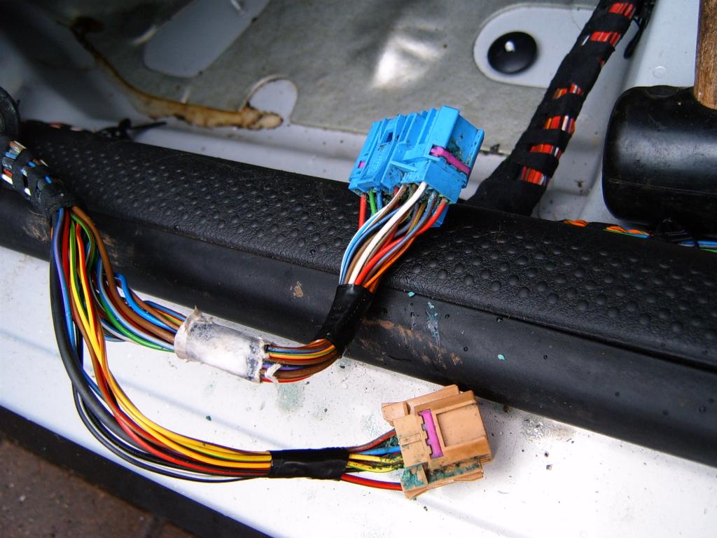

spadders Posted June 2, 2011 Report Share Posted June 2, 2011 Hi guys, I have an '03 Passat estate, never had a problem with water leaks up until now, but came out to it the other day after some torrential rain, only to find myself paddling in water in the drivers footwell, checked the back and it was about 3 inches deep in water. After checking the forums, I checked the plenum box, only to find the servo about half submerged and water lapping just below the pollen filter. If you can call it luck, then I have had a bit, because all of the water is in the drivers side, and so far all of the electricas are working fine. I drained the plenum by pushing out a bung from underneath. If you put your arm under the front edge of the plenum, roughly in line with the centre of the battery, there is a bung you can push out and replace later. I removed the wiper blades and snapped my screen trim trying to get it off (didn't remove the two little fiddly trims at the bonnet hinges first) After removing the battery and carrier, and sliding my alarm out of the way, I found both drain plugs completely blocked. I cleared the one under the servo and removed the one under the battery completely. While it was all off I decided to check the pollen filter housing seal. Amazingly this was intact but being sponge was saturated. I popped to my local VW dealer and got talking to a mechanic outside who went and fetched me some of the new sealer they use and just gave it to me, result My problem now is, I can't seem to get the inner sill trim off so I can dry out under the carpet. I've got the front "A" post end off, and all the way to the rear arch, but can't see how it come off at the back arch. I've removed the screw under the seat, but what else holds it in? I tried to look at the links that passatchris put in, but they're dead. Cheers guys, and thanks for reading to the end. spadders Quote Link to comment Share on other sites More sharing options...
Kenspassat Posted August 25, 2011 Report Share Posted August 25, 2011 Ive done the drain holes, pollen filter, dried out the carpet, and repaired the connecters, and still found water in the car after the next rain fall, which soaked the CCU and blow a fuse, now the read doors are locked. Currently waiting for a replacement CCU which will need programming. I did some tests and found the water was coming through the bottom of the passanger front door piller. Yep yet another place where water can get in. I took the multi connector housing of the boddy work, and found two small holes with water running through. So is the windscreen rubber or the Sunroof is most likely? Ill keep you posed. After reading some of these posts, I am begining to think VW did this to get more after service fees. Quote Link to comment Share on other sites More sharing options...
