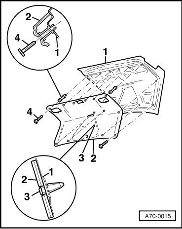

Joylove Posted October 27, 2008 Report Share Posted October 27, 2008 Hi I have a lead in from the boot lid. After heavy rain, I open the boot and a pint of water escapes from under the boot lid carpet and into the drain gulley. None of the carpet appears wet, and the lights still work. All very odd. How do I get the carpet off the boot lid? It feels and sounds ready to rip off the retaining studs (I assume) with just the lightest tugs. Quote Link to comment Share on other sites More sharing options...
slowwy1 Posted October 27, 2008 Report Share Posted October 27, 2008 There are screws covered in fibre of the same colour as the carpet. Look very closely and you should see them. You need to undo all of them(about 15), the two screws holding the plastic handle, take the warning triangle off, then there are two 10mm IRRC nuts holding the bracket. After that you need to slide the carpet out of the two clips next to the warning triangle bracket and it comes off. Quote Link to comment Share on other sites More sharing options...
Ska Posted October 27, 2008 Report Share Posted October 27, 2008 Prety straight forward but here's a pic to locate them more easily+++ Quote Link to comment Share on other sites More sharing options...
Joylove Posted November 2, 2008 Author Report Share Posted November 2, 2008 Thanks guys. I'd never have spotted those fixings. Quote Link to comment Share on other sites More sharing options...
