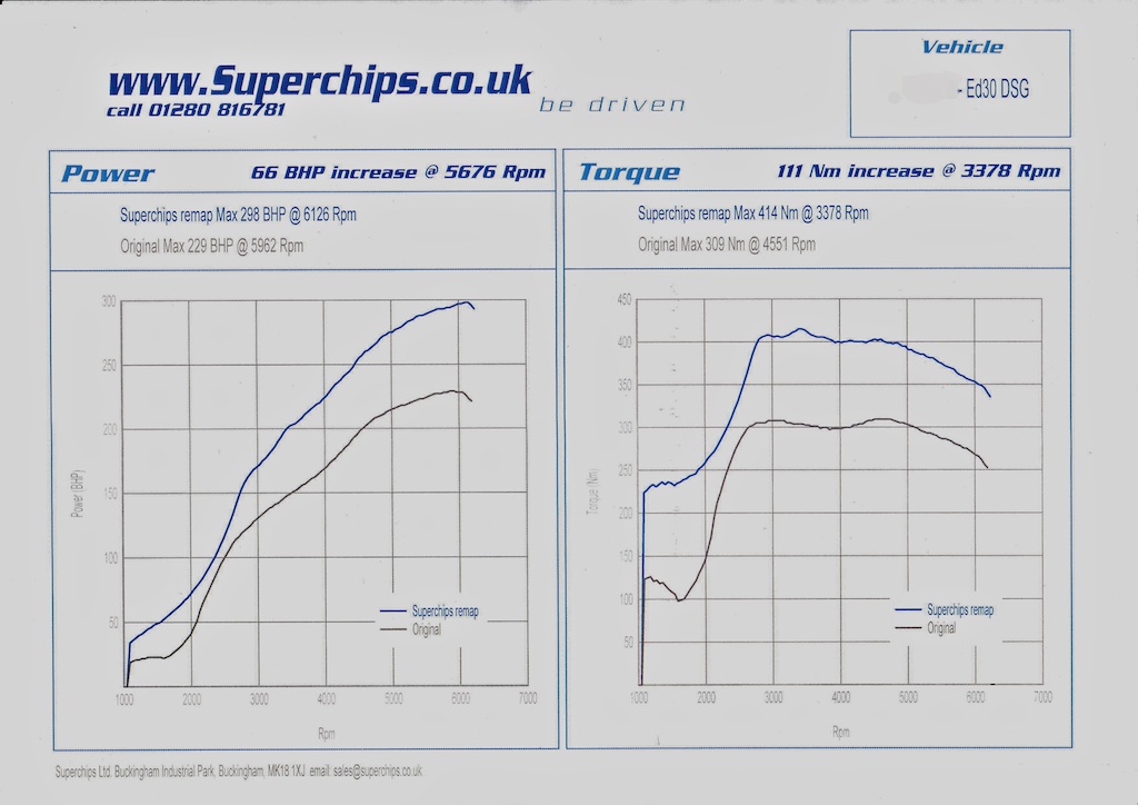

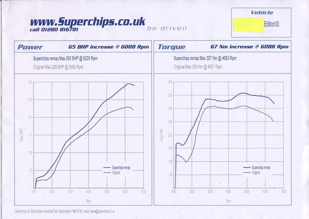

SO8 Posted January 12, 2009 Report Share Posted January 12, 2009 FWIW to anyone interested - Superchips rolling roaded my car as standard at 229bhp. Their first Stage one remap was a 'lower' torque version than their later and newest Stage one map. The graphs are attached for both maps. I am very happy with the maps and their service Compared to standard the car goes really well on the lower torque map and like stink on the higher torque one Link to comment Share on other sites More sharing options...
JonC Posted January 12, 2009 Report Share Posted January 12, 2009 Good power incerases there with both maps. Which will you settle for? Link to comment Share on other sites More sharing options...
SO8 Posted January 13, 2009 Report Share Posted January 13, 2009 Good power incerases there with both maps. Which will you settle for? Don't have to settle for one .... I have both Superchips emailed them both to me so I can load either into the Bluefin device and then put it onto the car. In addition I can also still revert to standard - not that I see me doing that ..... At the moment I have the lower torque remap on the car as it gives the TC less of a hard time in this weather. Once dry and warm I will load up the high torque remap as it is alot more As to which I end up using more - can't say yet as both are great Link to comment Share on other sites More sharing options...
