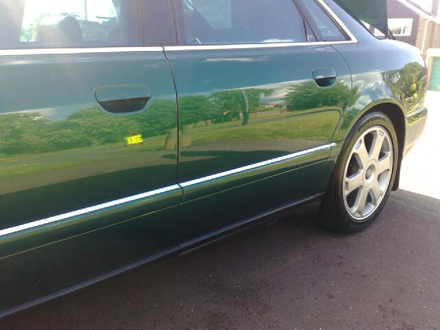

SINGH Posted May 14, 2009 Author Report Share Posted May 14, 2009 Here are the pictures as promised, quite shabby but you get the picture, excuse the pun :D This is what the key mark on the S8 used to look like, the only mark on the car(apart from stonechips)! After a G220 with Menz IP it started to look like this... Went over it some more and you really can't see it that very well anymore. You would have to know it was there to find it. Now the Porsche: Snowfoamed down Than did the usual clay etc... Now it was time to get the G220 out, these were the results! Swirl on door After going over with G220 Aftershots Believe it or not this A8 shot is also a reflection from the Porsches bodywork. What better way to finish off a post than some A8 p*rn ? :D Link to comment Share on other sites More sharing options...

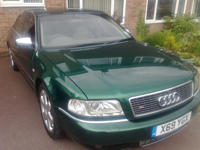

SINGH Posted May 22, 2009 Author Report Share Posted May 22, 2009 I have a bit of marring on one of the side doors, I will go over with power gloss and final finish plus top up with some supernatural on the weekend, allready done this to the bonnet. Heres some pictures of how it looks this week, I couldn't resist washing it even though I said I wouldn't and ended up finishing off the last of my Megs hyperwash yesterday. I have just now ordered some Duargloss 64 oz though! Cant wait to try that! Link to comment Share on other sites More sharing options...
steelwind101 Posted May 22, 2009 Report Share Posted May 22, 2009 Looks good! The FF (final finish) should leave it looking sharp and say the bumpers, tend to be softer so if you notice less relfection then you need to follow it up! If you have had a LED light and maybe in the dark put next to the surface what you might see (with out finishing down with light polish) is large halo around the centre of the light. When you have used the FF it should become sharp enough that you will see a bulb/light. Same with any bright light source such as a tube light. TT has some lights on a stand in his post and these would show more "halo" or "fuzz" around them if the finish needs more refining. Geoff Link to comment Share on other sites More sharing options...
