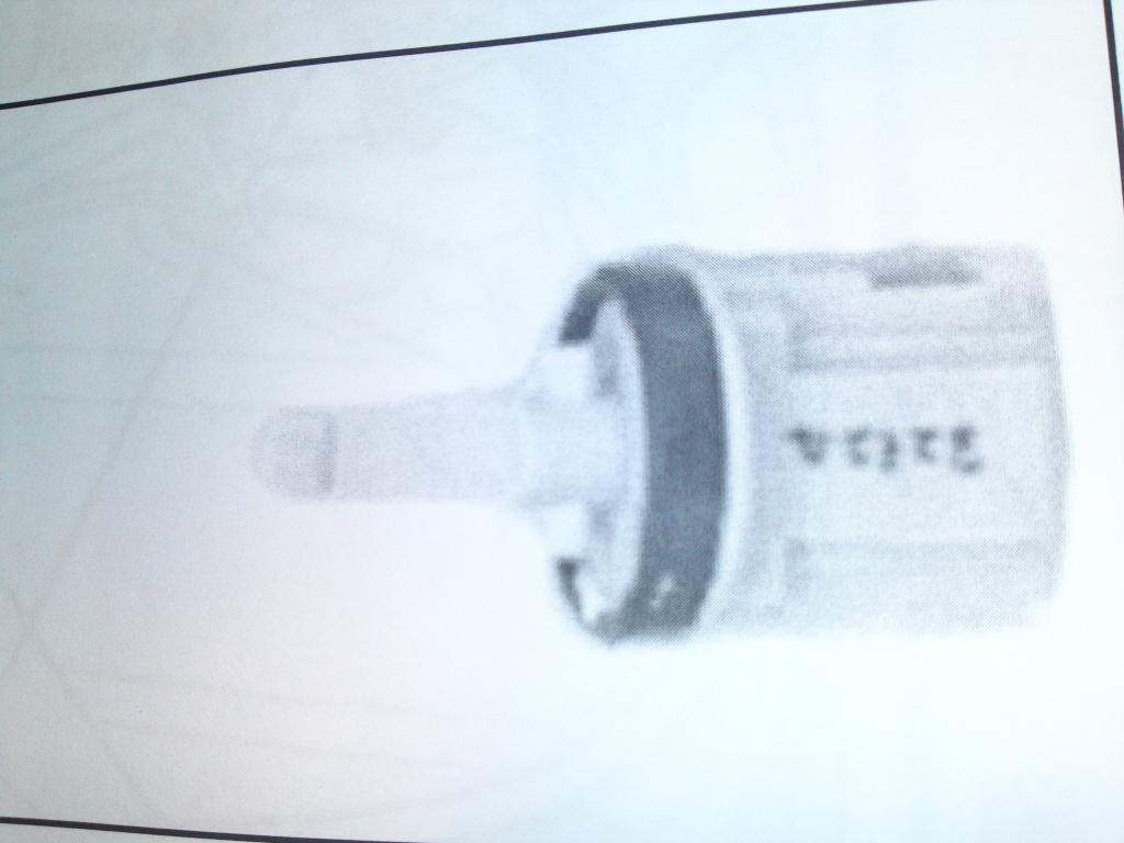

TIDYDUBS Posted November 17, 2010 Report Share Posted November 17, 2010 I thought i replied to this earlier but here we go again!!!!! Basically in a nutshell you evaporator inside the car is icing up resulting in a wet smelly carpet once it thaws out. Its the evaporator temp sensor adjacent to the clutch pedal above the foot rest.Its not quite long enough and needs to angle more into the airflow to help regulate the temperature. Ive replaced a few of these for this problem and are relatively easy to change. Ill PM you when i have the modified part number tomorrow............in the meantime strip out the seats, carpet and the sound proofing to get all the water out to do the job properly and dry that puppy out. Regards Tidy Link to comment Share on other sites More sharing options...

TIDYDUBS Posted November 18, 2010 Report Share Posted November 18, 2010 Its just one of those things the aircon drain cant take all of the water out. The drain could be detached? Plus water will find any way it can to get out. Worth a check. Just be careful on your seat removal AIRBAGS get a pro to do it if you dont know how to.Sounds like your dealer has not got a clue to be honest.....Where you located? Modified part number is 1K0 907 543 F temperature sensor not sure how much and no more than about 20 minutes to fit. Regards Tidy....... Link to comment Share on other sites More sharing options...

TIDYDUBS Posted November 21, 2010 Report Share Posted November 21, 2010 The original one will be of grey in colour, generally quite short too,this one here.The modified type is black and longer with the tip angled into the airflow. No real way of checking it its just not long enough just change it you will know the difference when the weather picks up again.Hope the pics are ok they are what i scanned earlier Regards Tidy Link to comment Share on other sites More sharing options...

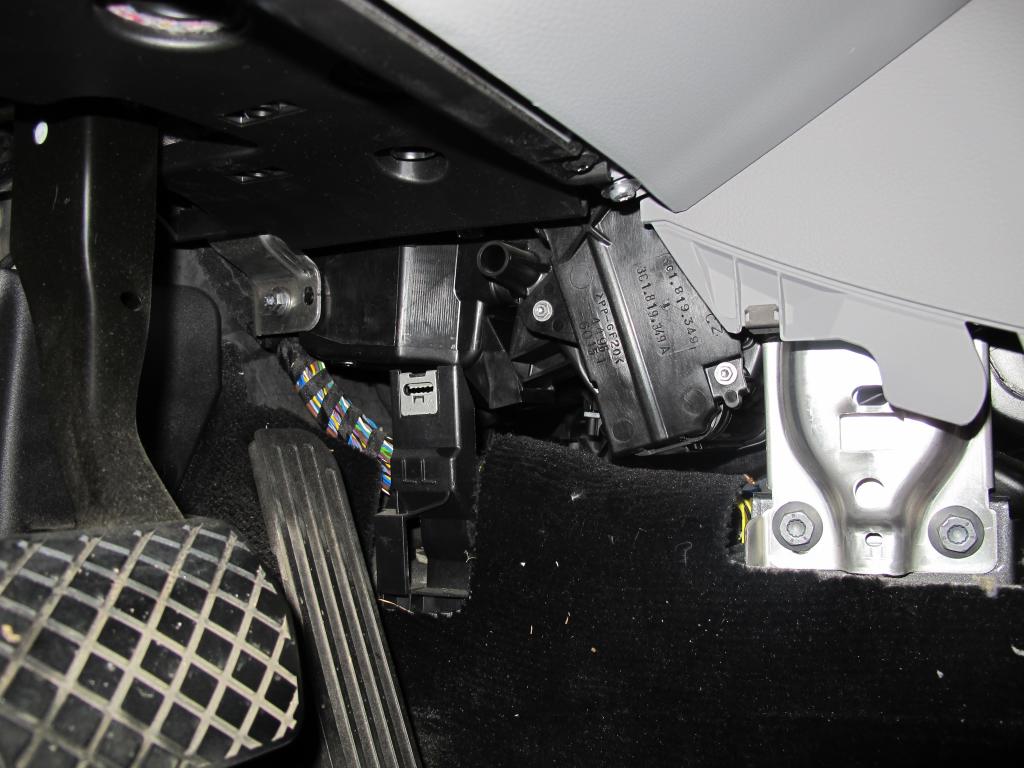

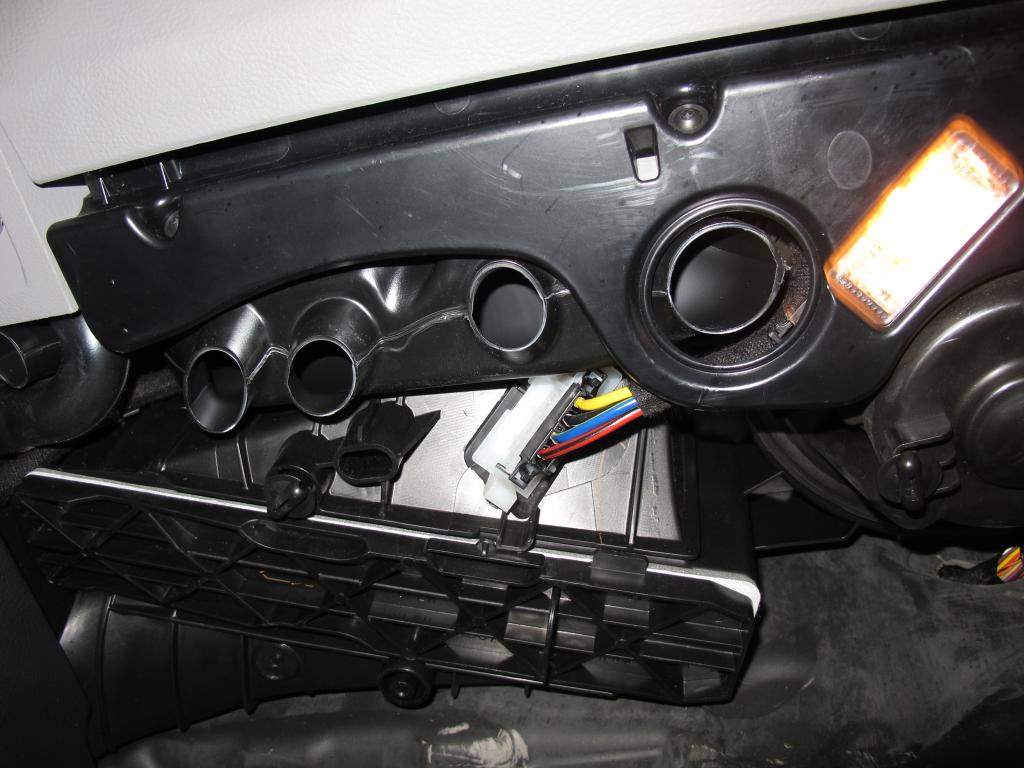

rrathi Posted November 28, 2010 Author Report Share Posted November 28, 2010 I feel so retarded TIDY... where do I find the heater box... These are the pics from under the dash (1st is passenger side and second is driver side)... where do I find it... if you need any more pics I will happily put them on... Link to comment Share on other sites More sharing options...
TIDYDUBS Posted November 28, 2010 Report Share Posted November 28, 2010 Ok no worries mate..........where the centre console is by the ash tray keep to the side there on drivers side and follow it to heater assembly, the bit that houses all the flaps and positioner motors, its more on the side near driver not the passenger picture......that there is your fan resistor and pollen filter you may need this info when that goes. Look at the drivers pic go to the right of that in line with the brake pedal there just a bit lower in that vicinity you may have to remove the trim thats there torx 20 screw its a long trim that runs parallel with the centre console.......as i said look both sides as im not sure on a U.S. spec car let me know im around all evening minus 5 with a tad of snow on the ground good pics by the way Regards Tidy Link to comment Share on other sites More sharing options...

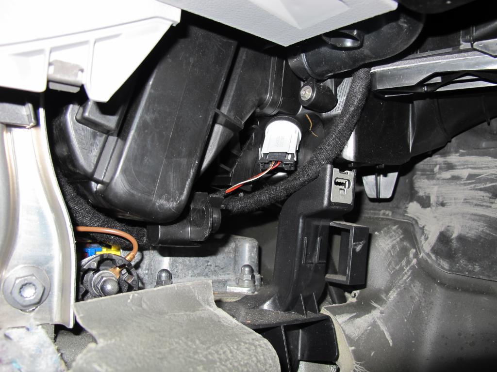

rrathi Posted December 1, 2010 Author Report Share Posted December 1, 2010 TIDY, could not find where exactly the sensor is I did open up the side trim but am not sure where to find the sensor... I am attaching 2 pics...1st (1636) is from the driver side and second (1637) from the passenger side... maybe you can help me locate it... Link to comment Share on other sites More sharing options...
TIDYDUBS Posted December 1, 2010 Report Share Posted December 1, 2010 Loving the pics good work!!!!!!!!see the pic without the pedals........that grey sensor with the red wire in the black connector grip the sensor and twist, dont force it. It should come out thats your temp sensor of which you need to fit the modified one as the pictures ive posted above....................hope all goes well.Regards Tidy Link to comment Share on other sites More sharing options...
rrathi Posted December 2, 2010 Author Report Share Posted December 2, 2010 Thanks Tidy. So when you say replace with modified one, do you mean the new one that I should be buying? Glad you like the pictures Link to comment Share on other sites More sharing options...
rrathi Posted December 2, 2010 Author Report Share Posted December 2, 2010 Thanks Tidy, I got it out... twisted it...easily popped out. Will buy a new one and let you know how much it cost etc! You are great... and thanks for bearing with me! Link to comment Share on other sites More sharing options...

TIDYDUBS Posted December 4, 2010 Report Share Posted December 4, 2010 No im not being funny you need that sensor in the picture, in the other posts a few back that i sent. That picture you just put up is a coolant temp sensor.....seriously now get the sensor with the bend in it. Those coolant temp sensors yea they did give grief but VW have modified that type to green 4 pin years ago and the later Passats have grey 2 pin which is NOTHING to do with your air con. GET the sensor in the picture i posted up with the bend in it. Link to comment Share on other sites More sharing options...
