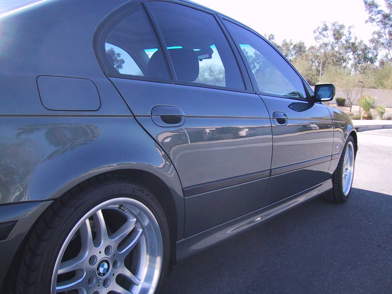

abooyeung Posted February 20, 2004 Author Report Share Posted February 20, 2004 I finally had a chance to detail the car with Zaino. I have attached a quick photo and will take more soon, but all in all, I am very please with the results. Very smooth to the touch! Link to comment Share on other sites More sharing options...
CARACTERE 007 Posted February 21, 2004 Report Share Posted February 21, 2004 looking good dude!! Link to comment Share on other sites More sharing options...

CARACTERE 007 Posted February 21, 2004 Report Share Posted February 21, 2004 wow that looks amazing dude!...thats one hell of a lip youve got on those alloys...what are they.. are they HRE's? Link to comment Share on other sites More sharing options...
abooyeung Posted February 26, 2004 Author Report Share Posted February 26, 2004 Hi CARACTERE 007, Thanks for your post. I am not sure what HRE stands for. The rims are similar to the 2003 7 series or M5 rims... or so the rep said. have a great day! Link to comment Share on other sites More sharing options...
