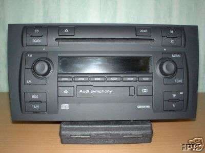

davebleloch Posted February 4, 2004 Author Report Share Posted February 4, 2004 I don't know if it's better...I wanted an Audi OEM head unit with a CD, which would also match the black console in my A6. Also I'm not keen on the flip-down CD cover. I think it looks pretty smart. I'll attach the pic I've got...there's more pics on my website http://www.theyellowhouse.fsnet.co.uk/images/a6/ The next job is to take the console out and see how the thing is held in there. Is there a decent workshop manual that covers 99 A6s? There's no Haynes manual and the Audi official one is a fortune. DB Link to comment Share on other sites More sharing options...
peterb Posted February 4, 2004 Report Share Posted February 4, 2004 It's held in there by four spring clips. These are released by use of the special keys inserted into the small slots above and below the columns of buttons on each side. Link to comment Share on other sites More sharing options...
