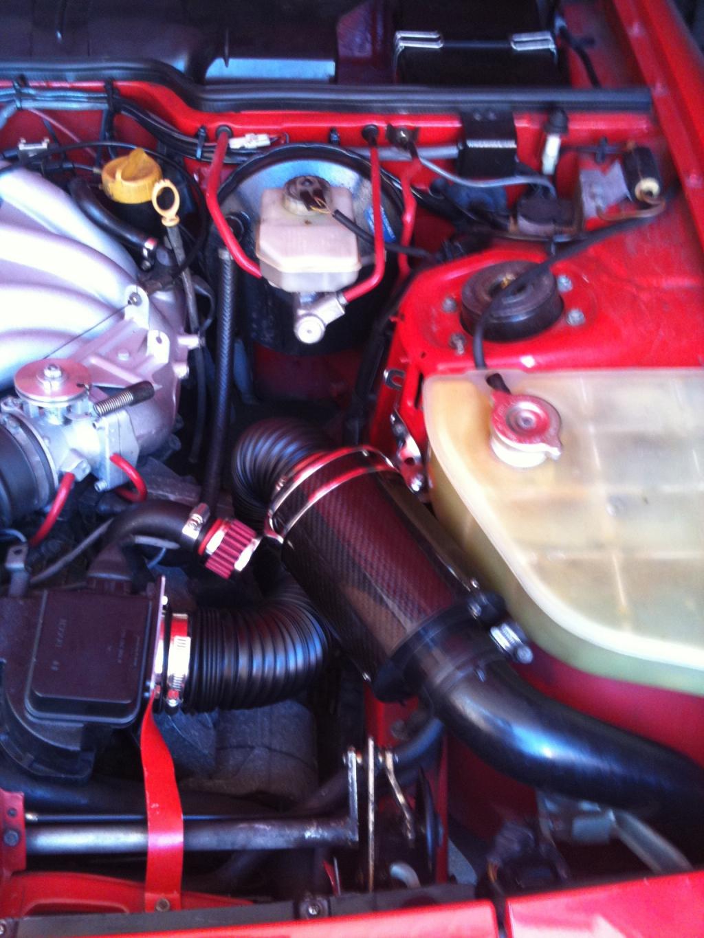

eldavo69 Posted July 14, 2011 Report Share Posted July 14, 2011 I changed the airbox in my 944 for an induction cone and have since changed it again. The standard airbox takes a cold air feed from the wing whereas the induction cone sounded great but was sucking in hot under-bonnet air. The bum dyno convinced you it was quicker due to sounding better but as the car warmed up the performance seemed compromised. I then changed to a carbon fibre enclosed induction cone (about £45 from eBay) and mated this to the original cold air feed. Much better! I also changed the chips to take advantage of the airflow, etc and performance is much much better. I wouldn't use an open induction cone under the bonnet again so see if you can get a carbon enclosed cone first and foremost. If (as your username suggests) you're based in Newcastle/the northeast then I've got some black flexi hose spare for mounting the filter wherever suits best. Quote Link to comment Share on other sites More sharing options...
