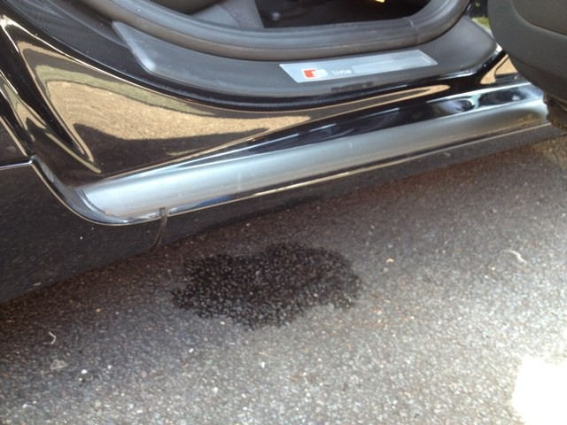

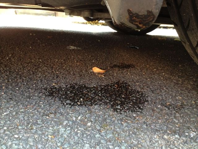

I need some help...last day or so as I drive I can hear water swirling around in the car somewhere...
When I turn in rear view I can see splashes of water in the road...
When I park I can see the water dripping...hopefully a couple of pics attached. What I've also noticed is that the back doors sills when you open the door are moist...
Is there a plug or something I can pull underneath the car to allow water out or is it a trip to dealers?

Put your hand down sides of the battery in the battery compartment, you may find it is flooded in there, if so, there is two drain points which are blocked, one under battery and other under the brake servo. Some remove them (including the Audi dealers) other clean them out. The drain points are also known as Drain Bladders, Drain Valves, Drain Tubes, One way valves, water drain valves, and plenum chamber.
