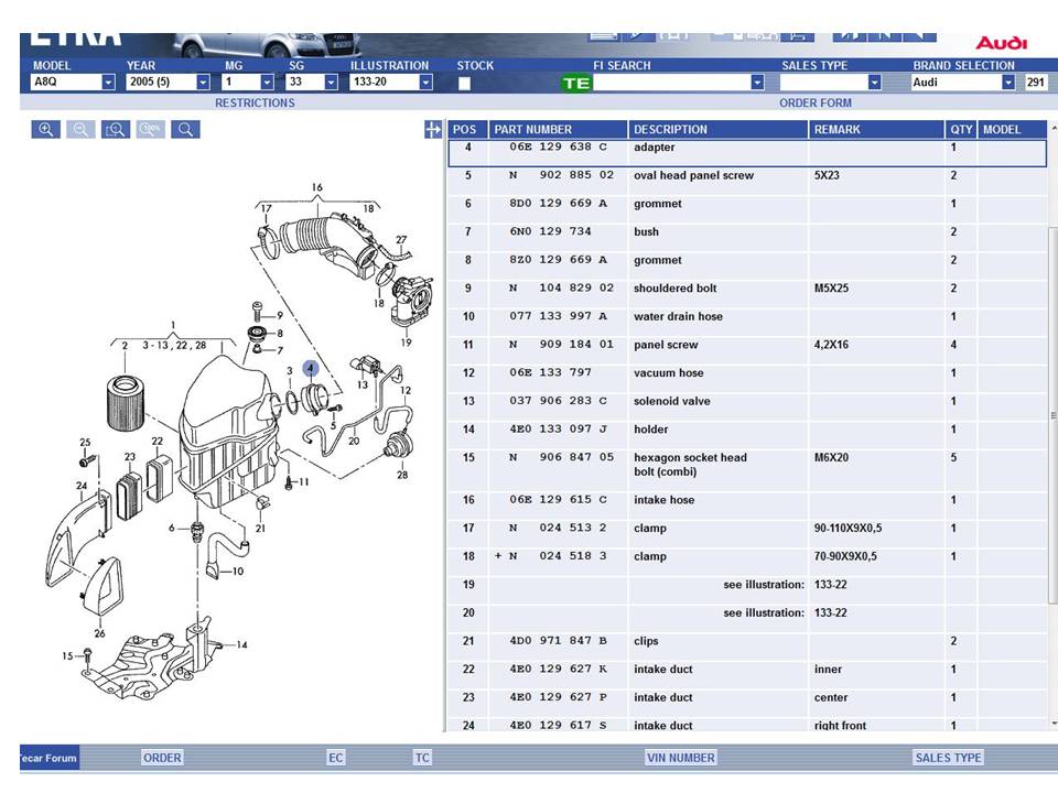

cruiser647 Posted April 20, 2013 Report Share Posted April 20, 2013 Looking on Etka, and I can't find it. Seems to be the only A8 engine with no air volume sensor. All the others have an illustration with the air cleaner housing and air volume meter. Your 3.2 only shows air cleaner housing. :confused: I'll keep looking for a bit more. Quote Link to comment Share on other sites More sharing options...
cruiser647 Posted April 20, 2013 Report Share Posted April 20, 2013 Looking further, and it would seem the FSI engines have it slightly different. See if you can remove the air pipe between air box and engine. Have a look through the tube and you might see it in there, hanging down. ETKA seem to call it 'an adaptor'. Hopefully it's there! Hope this helps! Quote Link to comment Share on other sites More sharing options...
M0rph_A8L Posted April 20, 2013 Author Report Share Posted April 20, 2013 Thanks for the pic, will have a look tomorow. I appreciate it Daz Quote Link to comment Share on other sites More sharing options...
