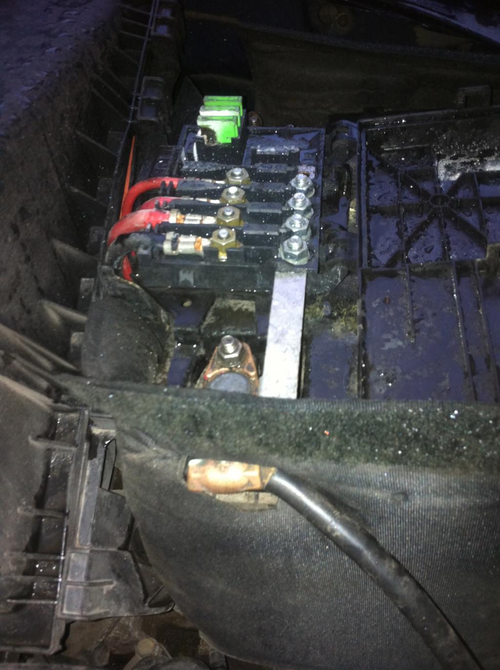

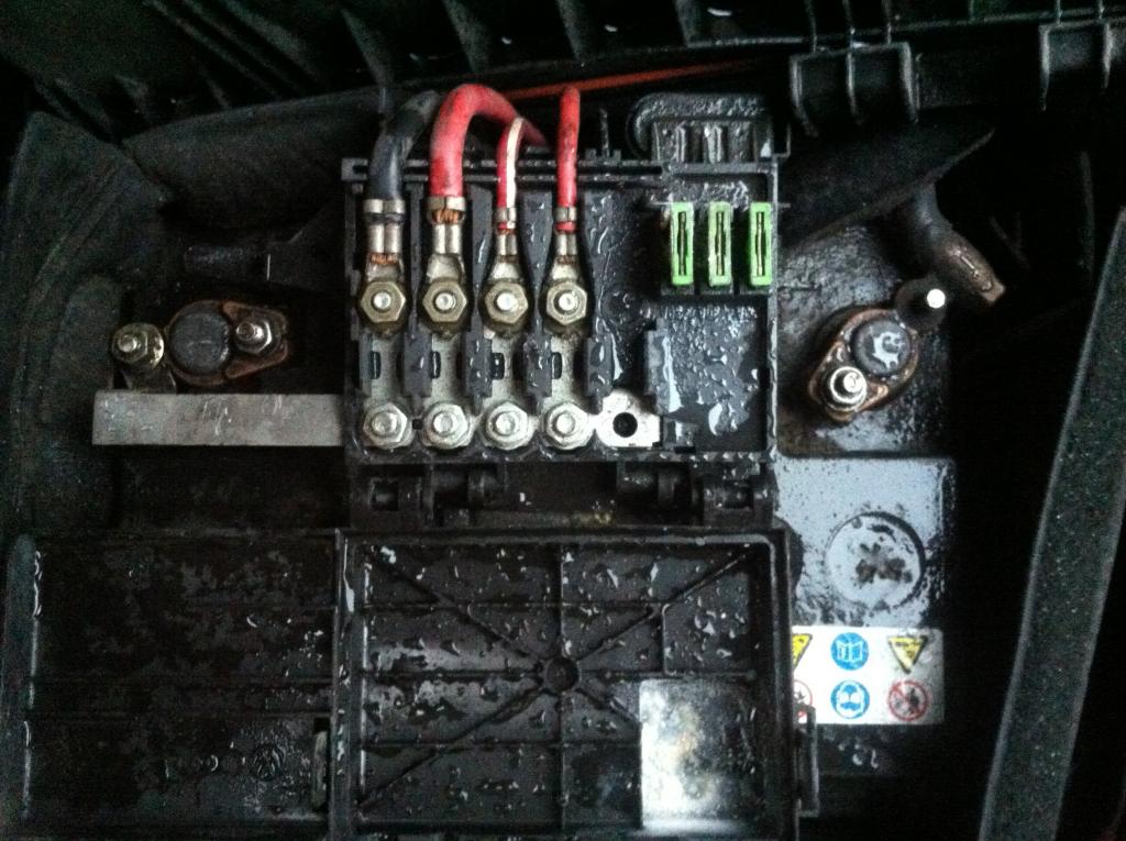

ekravik Posted April 14, 2013 Report Share Posted April 14, 2013 Hi I tried to jump start another car with my car, but I really couldnt figure out where to attach the red cable on my battery. The positive (plus) part of the battery is kinda lowered down. Please see picture. Anyone have any experience with this? Could it hurt to try around?! It's not easy attaching the cable to the plus-part of battery. See pictures. Thanks for any help! My car: Audi a3 1997 E Quote Link to comment Share on other sites More sharing options...
Twinspark Posted April 14, 2013 Report Share Posted April 14, 2013 In the first photo, the black cable is attached to the right hand terminal, which appears to be annotated with a '-' moulding on the battery. So I reckon the left hand terminal is the correct one... try to see if there's a '+' moulded into the battery next to it. Quote Link to comment Share on other sites More sharing options...
Tipex Posted April 14, 2013 Report Share Posted April 14, 2013 I think the issue is more to do with physically getting the cable on to the terminal rather than actually which one it is, as the daft terminal box with all the wires sits on top of the positive terminal leaving little room for the crocodile clips jaws. I've always just used that metal strip that goes from the terminal, into the box with all the red wires connected to it whenever i've had to jump a VAG car with that connector box. Quote Link to comment Share on other sites More sharing options...
ekravik Posted April 17, 2013 Author Report Share Posted April 17, 2013 I've always just used that metal strip that goes from the terminal, into the box with all the red wires connected to it whenever i've had to jump a VAG car with that connector box. Thank you. The problem i physical, yes. So your suggestion is to connect the black negative jaw to the black minus pole (right side) -- and then to connect the red jaw to the vertical metal strip seen in the picture, right? I just want to be sure.. Quote Link to comment Share on other sites More sharing options...
Tipex Posted April 18, 2013 Report Share Posted April 18, 2013 That's what I would do yes. Quote Link to comment Share on other sites More sharing options...
