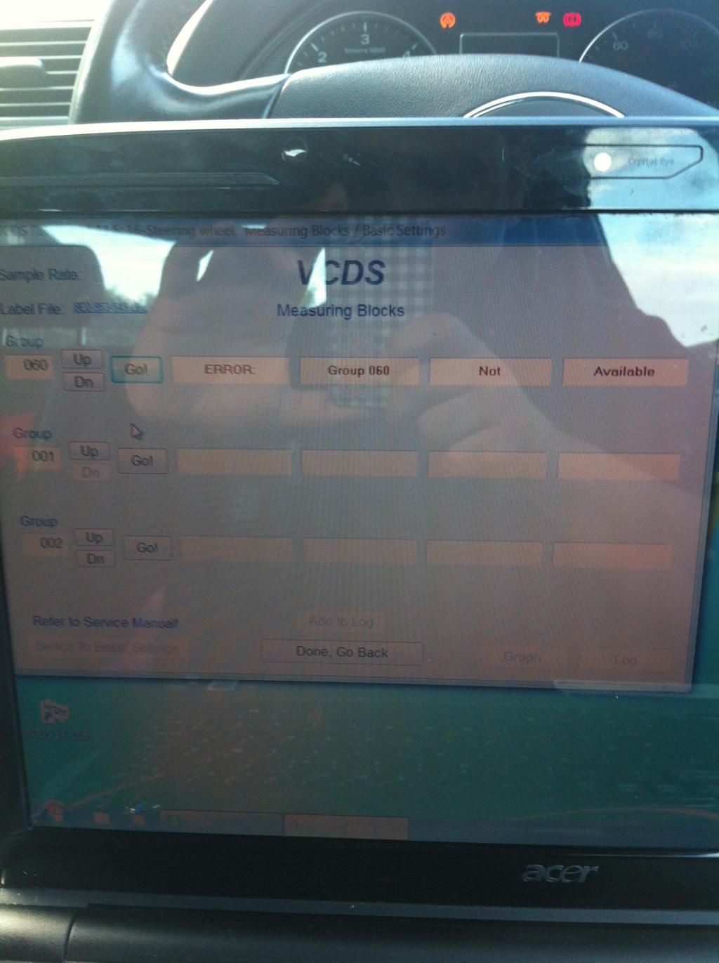

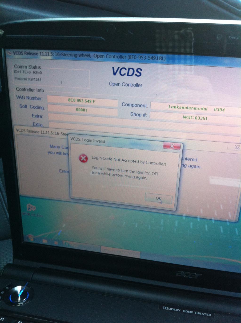

tab99_uk Posted August 11, 2013 Author Report Share Posted August 11, 2013 when I click on meas block 08 I get error group 60 not available I keep getting error login code not accepted by controller when I login. my esp light is still on genuine ross tech cable as you can see in pictures the esp light and glow plug light is still on. Link to comment Share on other sites More sharing options...
PetrolDave Posted August 11, 2013 Report Share Posted August 11, 2013 cleared the code still get the error brake light error the switch is a 4pin that I changed their is another switch a 2pin one should I change that one to. Sounds like it to me - until you get the brake fault codes to clear you won't be able to do the G85 reset procedure. Other thought - do you have "normal" brake lights or LED ones? If you have LED ones they could be the cause of the problem, try putting normal bulbs back and see what that does. Link to comment Share on other sites More sharing options...
