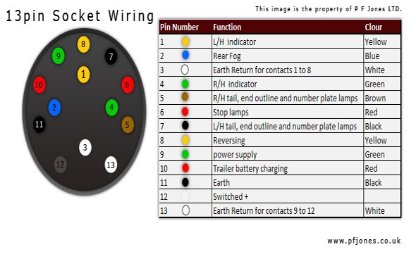

Mo-S3 Posted May 28, 2014 Report Share Posted May 28, 2014 Does he have the front cover that the terminals plug into? Is he technically capable of puttng the pins in if he had a wiring diagram to read from? iF its a genuine BMW towbar which i assume it is then there will bea retrofit pdf available somewhere if he doesnt have one already. once in hand you would need to identify each of the pins either by their colour coded cable or by testing each one( not as easy) and then inserting the pins into the correctly numbered cap. Link to comment Share on other sites More sharing options...
patently Posted May 28, 2014 Author Report Share Posted May 28, 2014 Ta I think the plastic cover is snapped into bits. I've suggested pushing the contacts into the back of a 13-to-7 pin converter, which is essentially the same thing. He's not the most technically-minded of us, though Link to comment Share on other sites More sharing options...
Calm Chris Posted May 28, 2014 Report Share Posted May 28, 2014 (edited) What does he have to use? Brake lights, side lights, indicators. I'd find a diagram for BMW 13 pin such as http://www.westfalia-loadcarrier.co.uk/eshot/installation/303460300113.pdf Which should be universal. There an infinite number of bodge ways of joining wire, such make sure you separate and insulate each one away from the next. Self amalgamating tape is your water proof friend in such matters (screwfix or Halfords). If he really isn't capable find a caravan centre, they will have a tow bar man that can do something. Edited May 28, 2014 by Calm Chris 1 Link to comment Share on other sites More sharing options...
