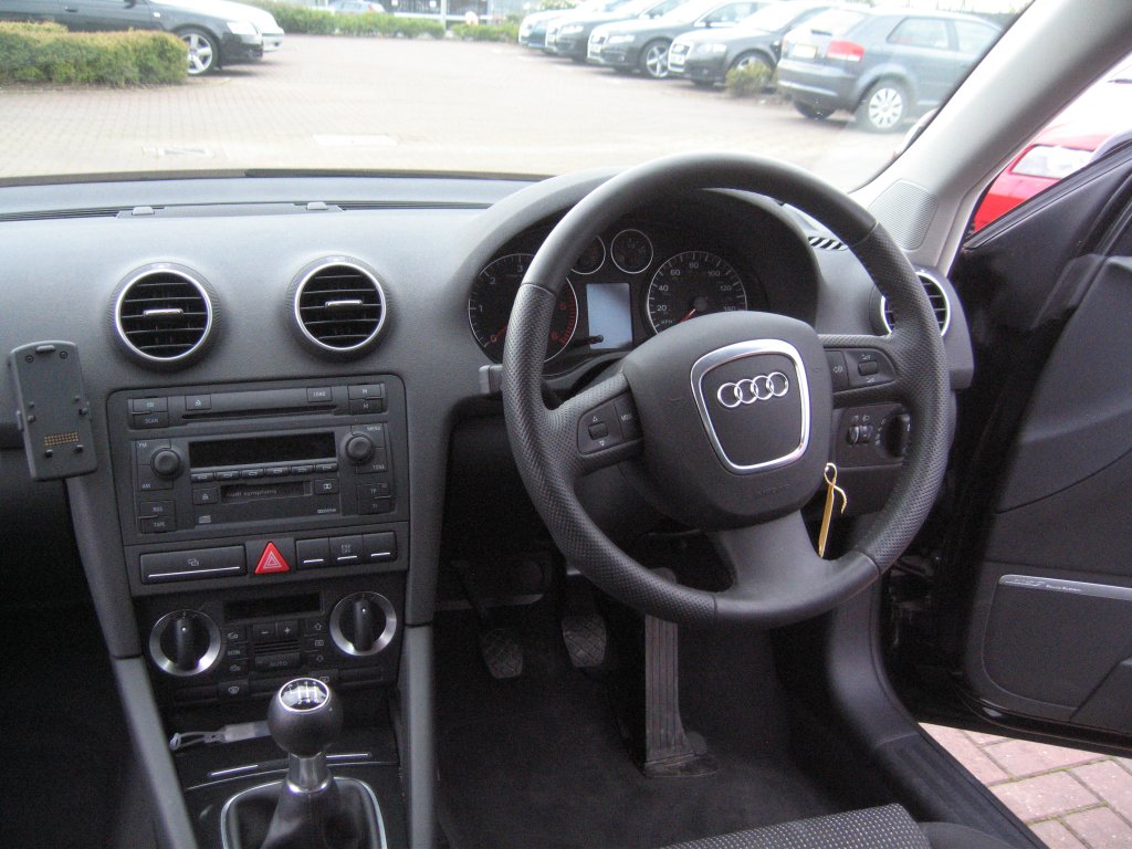

Ian_C Posted October 8, 2016 Report Share Posted October 8, 2016 Earlier 8P A3s (the model that ran from 2003 '03' to 2012 '62' and spanned three various 'faces' over its life cycle) had an optional hard mounted phone cradle. Archive pic of my dads old 55 plater Sportback below. From memory - and I could be wrong here because it varies on the different Audi models - I *think* bluetooth was available if you had the Sat Nav / RNSE interface. So instead of the cradle you had bluetooth instead. This video shows a 2011 A3 with RNSE with bluetooth: On later models, you *possibly* might have also been able to option bluetooth with the more basic sat nav system (called BNS or BNS 5.0) instead of the phone cradle What dashboard stereo / sat nav system does your 2010 have? And does yours have the MFSW (multi function steering wheel)? Quote Link to comment Share on other sites More sharing options...
