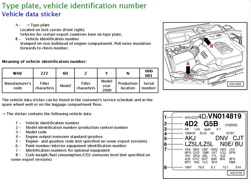

Sven Posted August 25, 2004 Report Share Posted August 25, 2004 Mort, lemme know if this info suffices. If you still need the wiring diagram I'll look it up. (I'll need MY, EC & TC though). Link to comment Share on other sites More sharing options...
Mort Posted August 26, 2004 Author Report Share Posted August 26, 2004 Thanks Paul and Sven.... Think I will need the diagrams but I will look at the door locks too... Forgive my thick-ness....What is MT, TC & EC ? Cheers.... Link to comment Share on other sites More sharing options...
Sven Posted August 26, 2004 Report Share Posted August 26, 2004 Model Year, Engine Code and Transmission Code (5). That and/or the model nr. (2). They are to be found on the sticker in your service booklet, and in the boot of the car (spare wheel compartment). See attachment. Link to comment Share on other sites More sharing options...
