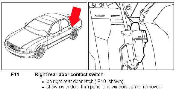

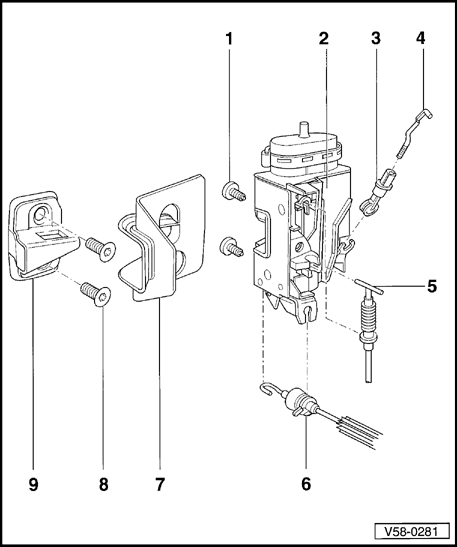

PaulW Posted January 7, 2005 Report Share Posted January 7, 2005 This is just a cut and paste from an old post....the switch is inside the door and it's broke. Both mine don't work...sometimes one does. Yes, we've discussed this a few times before, mine has the same problem. The switch is in the door latch mechanism, the Bently states that the whole latch mechanism has to be replaced, but I'm not sure. Here's a few pictures: Link to comment Share on other sites More sharing options...
