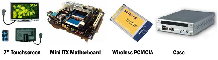

Sparky Posted January 26, 2005 Report Share Posted January 26, 2005 Yes, hopefully. I indend to put the 7" monitor at an angle, over the ashtray as I never use it and it should fit in between the two side parts that slope up towards the Climate Control. The attached piccy shows the components I've selected so far. The network card slots directly onto the board and allows me to pull up into the driveway at which point my network should detect it and start the synchronisation of MP3's to and from the car based on settings I'll create. I've nearly completed the software and have beta tested it with a laptop. As soon as I got near the house, the wireless network found it and MP3's started copying over. Link to comment Share on other sites More sharing options...

Sparky Posted January 26, 2005 Report Share Posted January 26, 2005 Intended Plans: <ul type="square"> [*]To have my entire MP3 collection in the car at any time (30GB) [*]To allow the system to remove songs I never listen to, so that the system isn't bogged down [*]Automatic playlist generation, depending on my mood. If I like the song I'm listening to, I press a button and all similar songs are queued up. [*]Car detected automatically when in proximity of house. Automatically collects new songs I've ripped to house PC and copies them over. [*]Personalised playlists for each driver [*]System to hibernate, rather than power-down to reduce boot-up times to just 1 second The touchscreen helps a lot but I can also get a Wireless Remote control to operate the system with, but I prefer the screen - but at £200, it's not cheap. Still, I can always amend the software easily enough. Screen shots of that will be ready witin days. Link to comment Share on other sites More sharing options...
