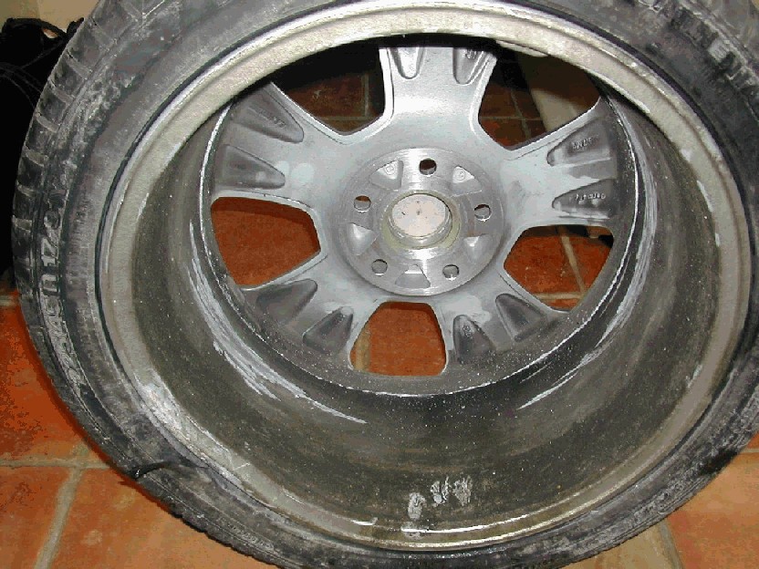

Crusader01 Posted January 27, 2005 Report Share Posted January 27, 2005 Headed off to the gym tonight, must have hit a hole in the road, tyre blows out. I think oh curses hope the wheel isn't scratched on the edges, it'll just be another tyre tomorrow and lots of wasted time. However when I get the wheel off its got a bit of dent on the inside edge but its also cracked and seperated 360 deg round just behind the front face so its totally wrecked. Also its come so loose that its has touched the brake disks. Whats my odds of getting a new wheel,tyre, brake disk and alignment out of Audi? Link to comment Share on other sites More sharing options...

Crusader01 Posted January 27, 2005 Author Report Share Posted January 27, 2005 RAC man who checked it over reckoned I'd hit an object, i'll have a scan round when its light. Strange thing is that the impact didn't feel anything like as bad as the damage is. I'll be after the Council and a new wheel tomorrow. C Glad the Sportbacks didn't get that puncture kit and did at least get a wheel of some sorts. A gallon of glue wouldn't have helped tonight. Link to comment Share on other sites More sharing options...

Crusader01 Posted January 28, 2005 Author Report Share Posted January 28, 2005 Well the news is:- those wheels are expensive £307 plus the tyre. Audi rather unhelpful and uninterested, the Tyre dealers had never seen anything like it before. In fact has anybody else ever had a wheel split in two? I walked the course this afternoon but couldn't find any holes, the edge of the road was a bit ragged but I don't think I went over the edge as the inner rim isn't scratched. I assume the Council stop bothering beyond the white edging line anyway on the assumption that its best to be on the right side of it. Having thought about it, I really don't feel I hit anything with sufficient force to bust the whole wheel in two, my guess is there was a flaw in the alloy somewhere. Bit disappointed in Audi I had expected them to send the wheel off for somebody to have a look at given the spectacular damage. Hopefully the new wheel will be here tomorrow AM and I can get to the Tyre place before they close. Bit hacked of with it really. C Link to comment Share on other sites More sharing options...
UBM Posted January 28, 2005 Report Share Posted January 28, 2005 Feck - the alloy split in two? Sounds like you hit a breeze block or something.. Hope you get it sorted. Link to comment Share on other sites More sharing options...

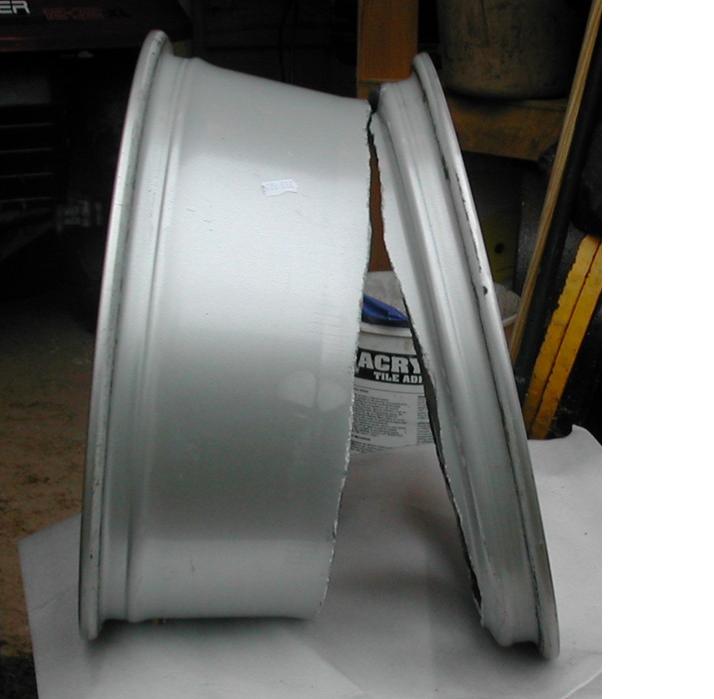

Crusader01 Posted January 29, 2005 Author Report Share Posted January 29, 2005 Here's another picture, got the new wheel and tyre on this morning and had the old tyre taken off the wrecked wheel. It seems that the rip in the tyre didn't actually puncture it, whatever I hit just bent the inside edge of the rim and then it just cracked in half. The tracking was OK ! Link to comment Share on other sites More sharing options...

jwo Posted January 30, 2005 Report Share Posted January 30, 2005 This happened to a colleagues BMW 17inch alloys. A stone was flicked up into the inside of the alloy, bounced around and split the rim. This may have happened to yours - hence you felt nothing. BMW (who have good customer service!) picked up the cost for the replacement wheel! Hope this may help! John Link to comment Share on other sites More sharing options...

Crusader01 Posted February 11, 2005 Author Report Share Posted February 11, 2005 Update:- Having been told to clear off by Audi locally and HQ. I submitted a report to VOSA and a few days later got a call saying that my wheel would be collected and taken to VAG, which it has. So I am a little more content in that they are now having a look at it. C Link to comment Share on other sites More sharing options...
