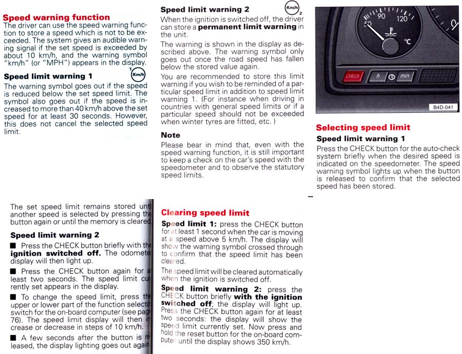

AnArtist1 Posted March 8, 2005 Report Share Posted March 8, 2005 Attached is a scan of the Speed Function thingy from the manual.... Link to comment Share on other sites More sharing options...
YiamCross Posted March 8, 2005 Author Report Share Posted March 8, 2005 [ QUOTE ] Attached is a scan of the Speed Function thingy from the manual.... [/ QUOTE ] You're a gentleman, many thanks. Link to comment Share on other sites More sharing options...
