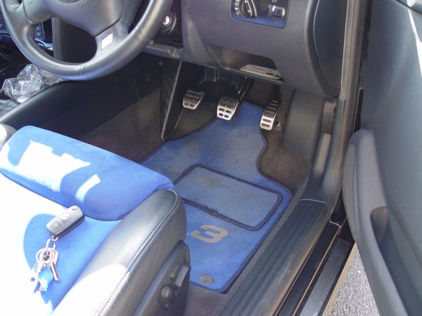

Chelsea Mick Posted May 4, 2003 Report Share Posted May 4, 2003 After a previous disscussion on here, decided to put some TT pedals on my S3. After seeing these go for over £35 on EBay, popped into my local dealer to enquire about prices. £6.50 (+VAT) each for the brake and clutch pedal and £2.10 (+VAT) for the throttle pedal Total £17.75p (inc VAT) Fitting was easy peasy. Old ones just pull off, new ones just push/slide on... End result..... Joyus Link to comment Share on other sites More sharing options...

Ess Three Posted May 4, 2003 Report Share Posted May 4, 2003 [ QUOTE ] They like really good I purchased some R32 pedals to fit my S3. The clutch and brake ones fitted fine but the go faster pedal one was way too big so i had to send them back [/ QUOTE ] I think yo must have got a LHD accelerator pedal by mistake...I fitted a set to my ex g/fs Lupo GTI and we had the same problem...after complaining and checking we realised we had been sent the wrong accelerator pedal cover...with the correct RHD part fitted all is well. They fit straight onto an A3, S3, TT, Golf4, Lupo etc...and need a slight bend to fit a Golf3....so I'm sure you had the wrong pedal cover. Link to comment Share on other sites More sharing options...
Chelsea Mick Posted May 4, 2003 Author Report Share Posted May 4, 2003 [ QUOTE ] Dude can we have some part numbers? they look sweet! [/ QUOTE ] Clutch pedal - 8N0721174A01C Throttle - 8N272164B Haven't got the part number for the Brake pedal as they originally gave me 2 clutch pedals then just swapped one of them for the brake pedal without another ticket.... Link to comment Share on other sites More sharing options...

gambba Posted May 5, 2003 Report Share Posted May 5, 2003 [ QUOTE ] Clutch pedal - 8N0721174A01C Throttle - 8N272164B [/ QUOTE ] Mick, I'd be thinking your numbers be slightly out, and should be as follows (According to Etka); RHD: Clutch - 8N0721174 01C Brake - 8N0721173 A Accel - 8N2721647 B LHD: Clutch - 8N0721174 01C Brake - 8N0721173 A Accel - 8N1721647 B Gambba Link to comment Share on other sites More sharing options...
