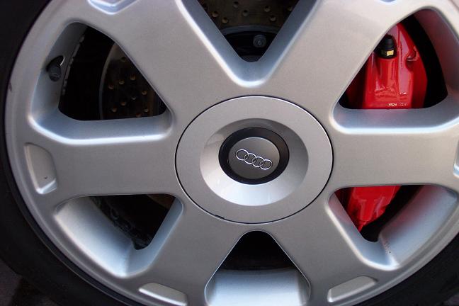

Hopsta Posted May 11, 2003 Report Share Posted May 11, 2003 Your memory cant be that bad Paul.... No spacers required with the standard Avus 17" wheels and Porsche 993 setup. Heres a pic of mine only a few weeks ago, before the RStt's went on. You'll see that its a little tight. Link to comment Share on other sites More sharing options...

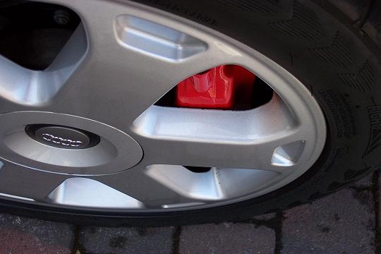

Hopsta Posted May 11, 2003 Report Share Posted May 11, 2003 and another.... Link to comment Share on other sites More sharing options...
SammyS3 Posted May 11, 2003 Author Report Share Posted May 11, 2003 thanks guys, I think they will need spacers, that does look a little 'too' tight! Black 993 Turbo brakes it is then... and 10/15mm spacers. Oh, are they the same front and rear? and how do they perform (fade/bite etc?) Sam Link to comment Share on other sites More sharing options...
