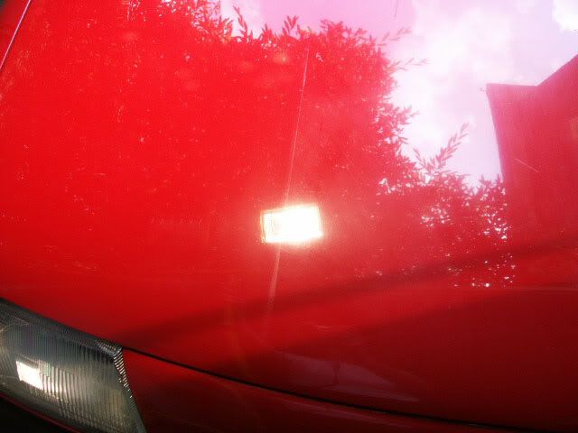

NeilScarrott Posted September 17, 2005 Report Share Posted September 17, 2005 Summary Ok used my PC for the very first time today, the weather was just perfect, a bit chilly bit a gorgeous day. I thought i'd start out on a small area and get used to my new toy so I decided to have a go on the rear bumper of my 3 year old Audi A4. I got the car a few months ago and the condition is very good, it has some light swirling which seems to suggest it spent it's early years in a car wash (my next task!). It also had some, what I would describe as 'clouding' in the paint of the rear bumper plus some small scratches which I can't remove with the PC. The pictures show before and after, my photography skills aren't great, but I think you can see the clouding in the first few photos (lower part of bumper). All in all I was very pleased with the result, the clouding was removed and I can see a big improvement. Products I used PB SSR 2.5 on SFX1 Yellow spot pad PB SSR 1 on SFX2 White spot pad Clearkote RMG on SFX3 Blue spot pad PB EX-P on SFX3 Blue spot pad Collinite Marque D'Elegance on LC Black Finishing spot pad My Experience I found the clouding wouldn't budge unless I switched to the Yellow spot pad after trying SSR 2.5 with the white spot pad, I had to go right up to speed 6 with several passes to get a good result. I think this caused some slight micro marring on the paintwork, very tiny small scratches, is this typical? I am not sure I totally eliminated this, but I thought I would try SSR 2.5 on a slower speed and follow up with SSR 1, does anybody else have any advice/tips? I wasn't too sure on how much product to apply, I generally went with four pea sized amounts of products on the pads, after a few iterations I found the pads starting to cake so let off on the application of product, any tips on how much to apply? I wasn't particularly sure about application of RMG, EX-P and Collinite wax, what speed works best? I went down to speed 4 with light pressure on the pad, is this the way to go? I found application of wax a bit tricky in terms of judging how much to apply to the pad, being used to hand application I found I could clearly see where the wax was. However the PC applies it so thinly I'm no longer sure. Before the pics, just to thank everybody for the help in getting this far! Pics Before, Hazing in the lower part of the bumper (not as clear as I would have liked, poor photography!) And now the after shots!! Link to comment Share on other sites More sharing options...

NeilScarrott Posted September 18, 2005 Author Report Share Posted September 18, 2005 Thanks! That is seriously good advice, got a few days off soon, going to go over the entire car to remove the swirls. The pics don't show up an awful lot i'm afraid, when I go about removing the swirls I will be able to post some far better pics, but the cloudiness is quite difficult to photograph! If you look closely on the second before pic, you can notice some cloudiness. One thing I found very alarming when using the yellow pad with SSR2.5 was on a small section when it got pretty hot the paint went opaque, almost in an instant, I immediately stopped thinking I'd burnt the paint, after some buffing it all came out to reveal clear paintwork. Perhaps a stage too far with the PC? Link to comment Share on other sites More sharing options...
