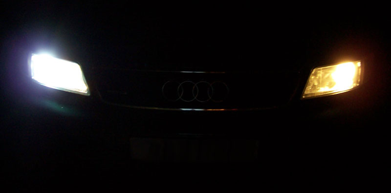

nikw Posted December 4, 2005 Report Share Posted December 4, 2005 Right. Took some pics tonight: Link to comment Share on other sites More sharing options...
nikw Posted December 4, 2005 Report Share Posted December 4, 2005 Another: Link to comment Share on other sites More sharing options...
nikw Posted December 4, 2005 Report Share Posted December 4, 2005 And one taken in daylight a while ago: Mine are 6000K capsules. The colour reproduction isn't great, but this last pic is probably closest to how they look in reality. Link to comment Share on other sites More sharing options...
Ska Posted December 5, 2005 Author Report Share Posted December 5, 2005 Cheers for that Nick Clean 8 but your garage on the right needs a bit of work Suprising how the HID's make the halogens look like candles BTW whats that black box in the bottom left hand corner of the screen? Link to comment Share on other sites More sharing options...
