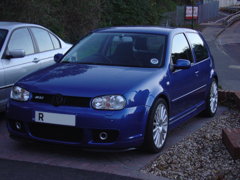

Dan32 Posted November 11, 2005 Report Share Posted November 11, 2005 Supposedly 20mm at the back is a bit too much and will affect the handling, although I know it looks cool. I've got 15mm spacers on rear and 10mm on the front and if I was going on looks alone, I wouldn't have bothered with the fronts. I payed £250 for 4 spacers, longer bolts and a set of McGards locking bolts, although I think Tom's link will do this cheaper. Link to comment Share on other sites More sharing options...

Mook Posted November 11, 2005 Report Share Posted November 11, 2005 I run 10mm spacers all round, but only to get the front wheels to fit over the brake calipers following the ECS upgrade. Don't go to 20mm on the rear - too much strain on the rear hubs. IIRC, Dan32 runs 15mm spacers on the rear. H&R is the way to go - as per Helfinger's post above. Best of luck Link to comment Share on other sites More sharing options...
Dan32 Posted November 11, 2005 Report Share Posted November 11, 2005 Aye, here they are... Link to comment Share on other sites More sharing options...

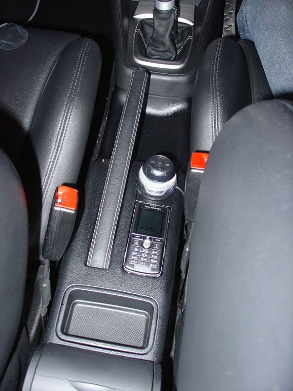

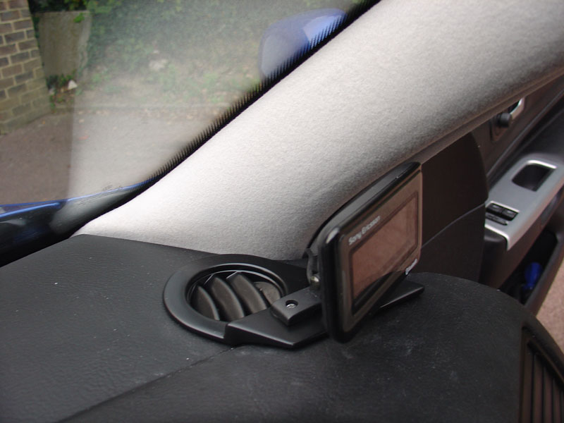

Dan32 Posted November 15, 2005 Report Share Posted November 15, 2005 Mark32 - You're going to hate me. I built some parts as didn't want to drill thru the dash and couldn't find a flat surface to mount anything! I made some cardboard templates, transferred this to plastic, and then sanded it all to fit in the little slot next to the handbrake. As for the screen, took out the demister vent, and made a plinth, again in plastic, and mounted the demister vent in it so that it would slot straight back into its hole and provide a way of holding it in place, blended it all in with bodyfiller and sprayed it up. Some photos: Link to comment Share on other sites More sharing options...
Dan32 Posted November 15, 2005 Report Share Posted November 15, 2005 And with the phone: Link to comment Share on other sites More sharing options...
Dan32 Posted November 15, 2005 Report Share Posted November 15, 2005 And the screen: Link to comment Share on other sites More sharing options...
