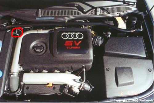

s3geezer Posted January 27, 2006 Author Report Share Posted January 27, 2006 Well it's not the fuel filter then. This is the area of the engine bay that smells petroly.... (hope this link works.....) Link to comment Share on other sites More sharing options...
s3geezer Posted January 27, 2006 Author Report Share Posted January 27, 2006 What thing is inside that red circle?? It has lots of hosey things. Any particular fiel related thing worth checking apart from all the hoses? The carbon filter works, it ticks away as usual on tickover but if you put your nose right in the area where the red circle is in the above picture it smells of fuel and sometimes when I stop and the engine idles fuel whiffs come throught the venting system. Independent garage going to have a look for me tomorrow so I'll let you know the results. Link to comment Share on other sites More sharing options...
s3geezer Posted January 28, 2006 Author Report Share Posted January 28, 2006 Well they said no leaks found either but when they fixed my water pump last week, they said a bit of fuel had got spilt in the engine bay (sounds complete bollox if you ask me) so they steam cleaned the engine bay to get rid of it. Just went to Bournemouth and back and I didn't notice the smell when we stopped etc in traffic. M'eh......must be one of those mysteries of life (unless what the garage told me is true...) Link to comment Share on other sites More sharing options...
