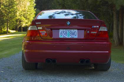

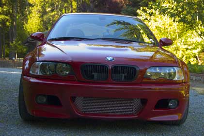

Roninpb Posted January 28, 2006 Author Report Share Posted January 28, 2006 [ QUOTE ] <snip>No comment. [/ QUOTE ] I rarely use the foglights and plan to add an Imola Red grid ot finish the fornt end. I'd save a few lbs up front and w/the addition of the app 100lbs SC kit (& W/A injector) I need to drop some front end weight. Hmm, maybe an LTW hood? Can you say Vorsteiner? [ QUOTE ] Seriously tho, sounds like a fab car ... any chance of some pics and performance stats? [/ QUOTE ] Thx! All I have are ten old, lousy pics but everyone else ahs demanded them (other sites) so I shall post them. Pease no flames over the poor image quality. Ronin Edit: Hmm, looks like I can only post one file at a time. Before I drive myself crazy <pun intended> is ther a way for me to attach multile pics to a post? Peace, Ronin. Link to comment Share on other sites More sharing options...

Roninpb Posted January 29, 2006 Author Report Share Posted January 29, 2006 To C007: "I come in peace. Resistance is futile. There is no escape. I have you surrounded." And other (in)famous lines? Another pic... Peace, Ronin. Link to comment Share on other sites More sharing options...
