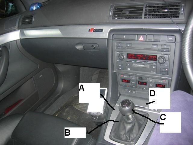

Oivind Posted January 29, 2006 Report Share Posted January 29, 2006 I want to replace the trim around my gearlever. How to do it? It's an A4 2002 Pardon my english don't have a dictionary on this computer Link to comment Share on other sites More sharing options...
UBM Posted January 29, 2006 Report Share Posted January 29, 2006 Hello! The trim just pulls out it one piece. Open the ashtray cover and push the trim upwards. You may have to take the gear level gaiter off the old trim, but I doubt it. The new trim just clicks back in! Link to comment Share on other sites More sharing options...
Oivind Posted January 29, 2006 Author Report Share Posted January 29, 2006 How do I remove the gear level? Have tried to unscrew it but it's stuck Witch way do I twist it? Link to comment Share on other sites More sharing options...
UBM Posted January 29, 2006 Report Share Posted January 29, 2006 Which trim are you trying to replace? A, B, C or D? Link to comment Share on other sites More sharing options...
UBM Posted January 29, 2006 Report Share Posted January 29, 2006 Well..... A, B, C or D. You can 50/50, phone a friend or ask the audience... Link to comment Share on other sites More sharing options...
Oivind Posted January 29, 2006 Author Report Share Posted January 29, 2006 The A trim. Link to comment Share on other sites More sharing options...
UBM Posted January 29, 2006 Report Share Posted January 29, 2006 Thought so - Just pull it off. You don't need to remove the gear lever knob or anything. If the leather gaiter is still attached, which it shouldn;t be, just prise off the clips holding it in place! IIRC the gaiter is held in place on a secondary metal mount underneath the trim part A! Link to comment Share on other sites More sharing options...
Oivind Posted January 29, 2006 Author Report Share Posted January 29, 2006 Thanks UBM It worked great Link to comment Share on other sites More sharing options...
